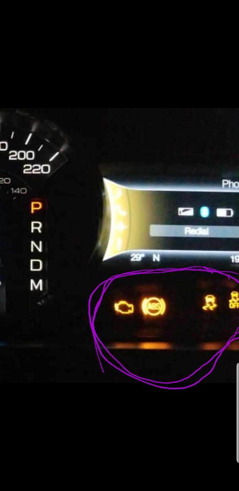

Mine did the same thing randomly. I found a tsb for a PCM update. Mine did it when I shifted randomly. I’ll pull the tsb and post it in the morning for you. Haven’t had a problem since I updated my PCM with my ford scanner. Unfortunately you’ll need access to a scanner that can program. It will also make you redo the PATS key (anti theft) so you’ll have to have all your keys with you.
i know ford dealers charge a lot sometimes at least here in California. Maybe they can help you out since it’s a TSB and known problem?
let me know if you want the TSB info.
