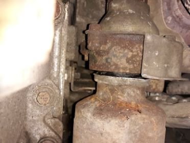

adworden Posted May 19, 2020 Report Share Posted May 19, 2020 2007 Edge SEL AWD. Trying to get the passenger axle out to replace the outer boot. Got the hub off, knuckle off, etc. On the inboard side of the axle there's what appears to be a 'collar' around the shaft. Does this have to be taken off to remove the axle? Any helpful suggestions? Can't even see how to get a hammer up there. Car's taken apart, sitting on jack stands, wife is not very pleased... Quote Link to comment Share on other sites More sharing options...

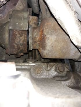

adworden Posted May 19, 2020 Author Report Share Posted May 19, 2020 This is the collar i am talking about. Looks like it's held on by 3 bolts. Does it have anything to do with holding the axle in? Quote Link to comment Share on other sites More sharing options...
ezndo Posted May 20, 2020 Report Share Posted May 20, 2020 Try to get a pry bar into that separation between the collar and the axle and see if the axle moves at all. If so, either continue with the pry bar or try to tap it out if you can. Look at a new axle for comparison. Quote Link to comment Share on other sites More sharing options...
