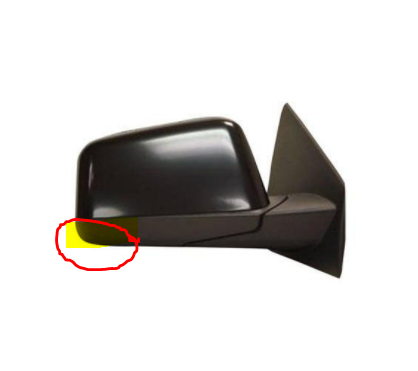

Recently purchased a 2007 Edge SEL and noticed today that the passenger mirror has a hole in it where someone obviously hit it.  The part that's damaged is circled in the photo below, it's the black portion on the corner of the mirror, not the paint matched upper section.  Does anyone know if this is replaceable without replacing the whole mirror?  Hoping to avoid having to get a new one painted to match.

Blufish312, Welcome, The painted section is a separate part of the mirror. Take care when trying to separate from lower section or you will break the clips. The lower black section isn't available as a separate part. You could buy a mirror, new or used an switch out the top section to avoid painting.
