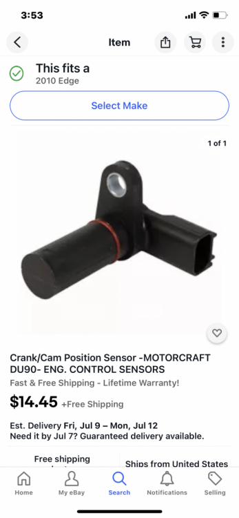

Might just order one of these guys too..
I am down to chasing parts. It’s the last thing I want to do, but I don’t know what else is left.
I did read a post on another forum suggesting adding Tc-1 or similar could help the fuel pump check valve. Going to look into this as well.
thank you for the reply.

wwwperfa_zn0w
suggested the new camshaft position sensor previously. I haven’t ordered one yet. Torn between buying another part and waiting to have the shop check the fuel pressure and having the actual mechanic troubleshooting on the 26th.

are there two camshaft position sensors ?

4 hours ago, WWWPerfA_ZN0W said:
yes, one on each bank.  confusingly, ford also refers to the timing phasers as actuators lol. the electronic sensors are underneath the intake tubing, a little work to get to them, but not bad.
That’s what I thought I saw on YouTube. With the fuel range changing (plus 70 miles) after putting the new battery and mass airflow sensor in, it kinda makes sense. If the pcm is re-learning, maybe a faulty camshaft position sensor keeps causing it to happen. Or the fuel pump, or fuel pump check valve… FML. I guess we shall see what the mechanic ends up finding. I will check the fuses today, just in case it’s a simple fix. Wouldn’t that be cool. Thanks again for the help.
