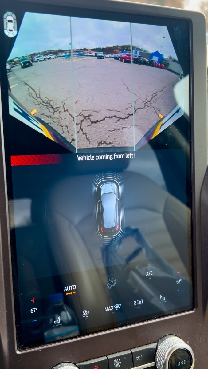

Wish you good luck. Maybe also study the possibility of enabling the rear camera to view 180 degrees like the front camera?
The rear 180 degree camera is so useful because you can see way more. The view is amazing! 🤩

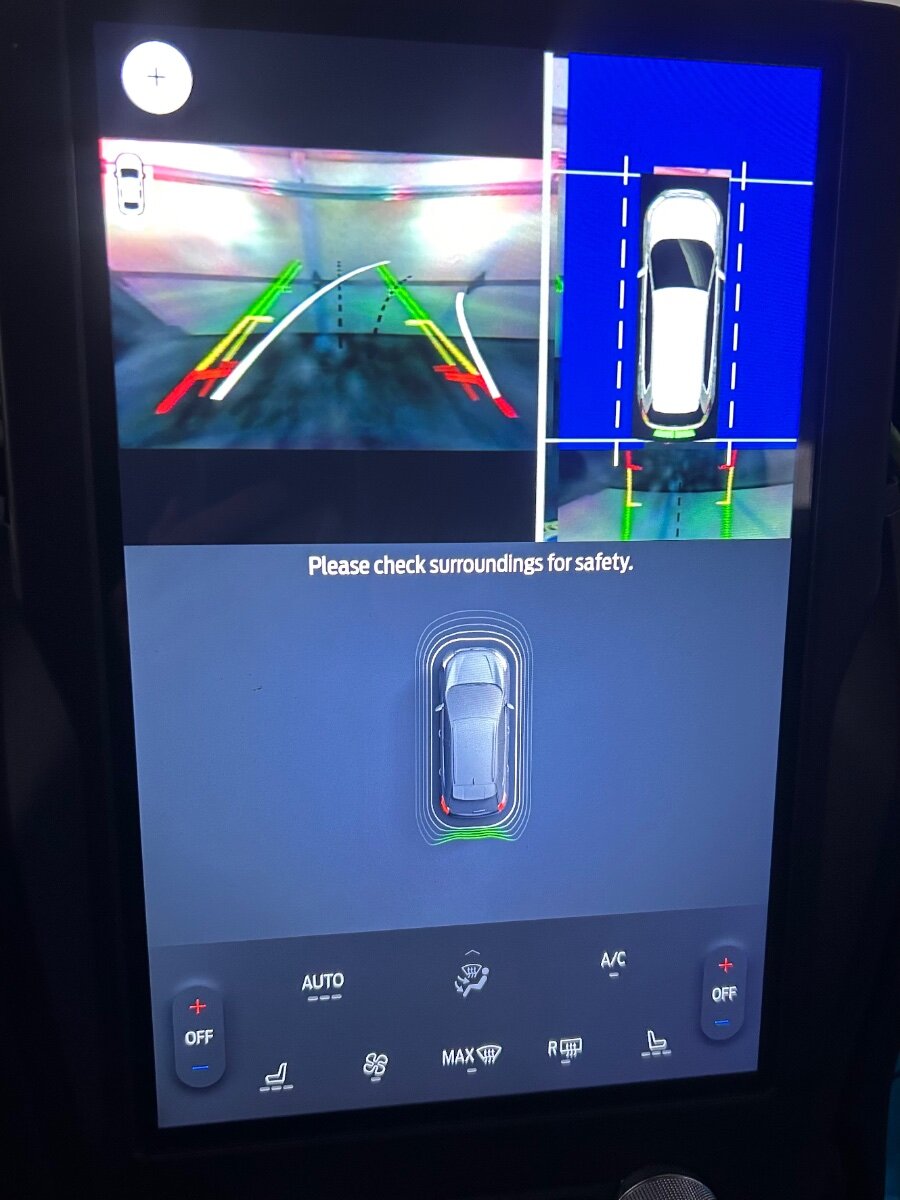

Still working on my cameras. I replaced the rear camera, so I have rear 180 Split View. I think that I will order an Explorer front camera bracket to mount a front camera without having to replace the bumper.
I can’t confirm if it is possible to align the cameras with the pattern and FDRS. I haven’t tried yet.

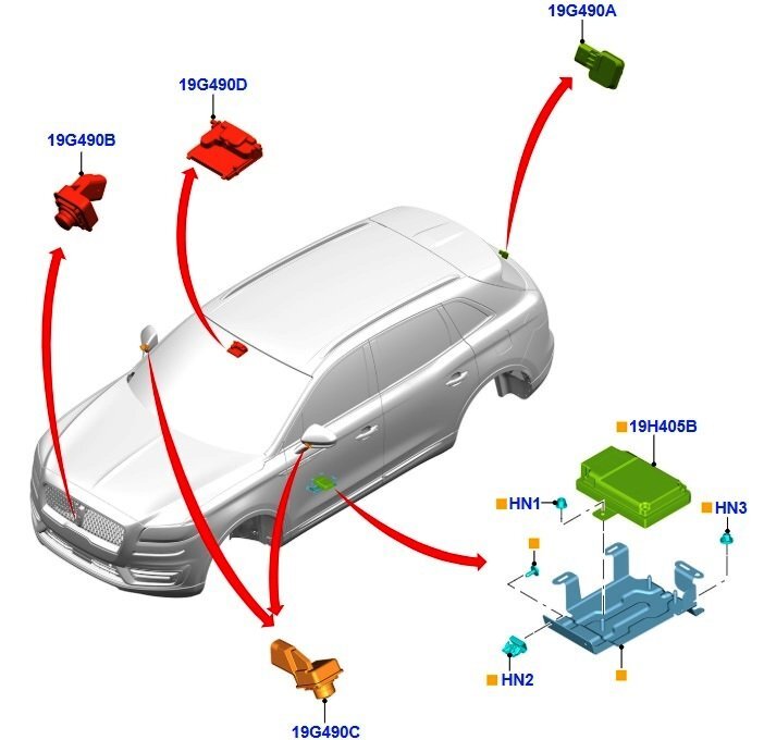

The only difference on your 2019 is that you have SYNC 3. Here is a picture of a SYNC 3 Edge with the 360 camera system:

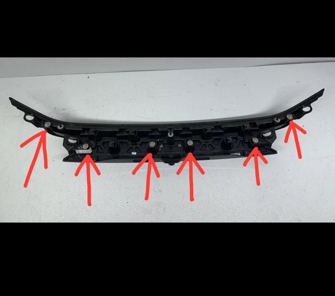

I am thinking that I should order a Ford Explorer front camera mount to install a front camera just below the Ford logo without having to get a new front bumper. The goal is to mount the camera as close as possible to the Edge that already have the front camera.
FB5Z19H421AA
Front Bracket
FB5Z19H421A
Collision Avoidance Camera Bracket | FordUS

I got a front camera, however there is a problem with the LIN communication. The front camera will show static guidelines if the LIN connection is removed. I don't have a front split view. I may have to order a different front camera.
