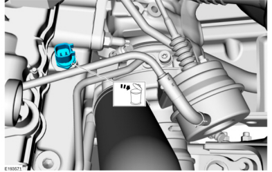

Cylinder Head Temperature (CHT) Sensor

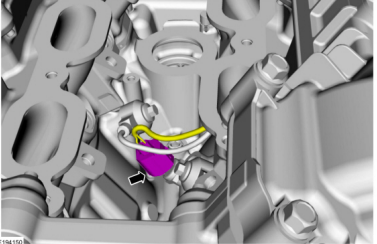

Engine Coolant Temperature (ECT) Sensor
