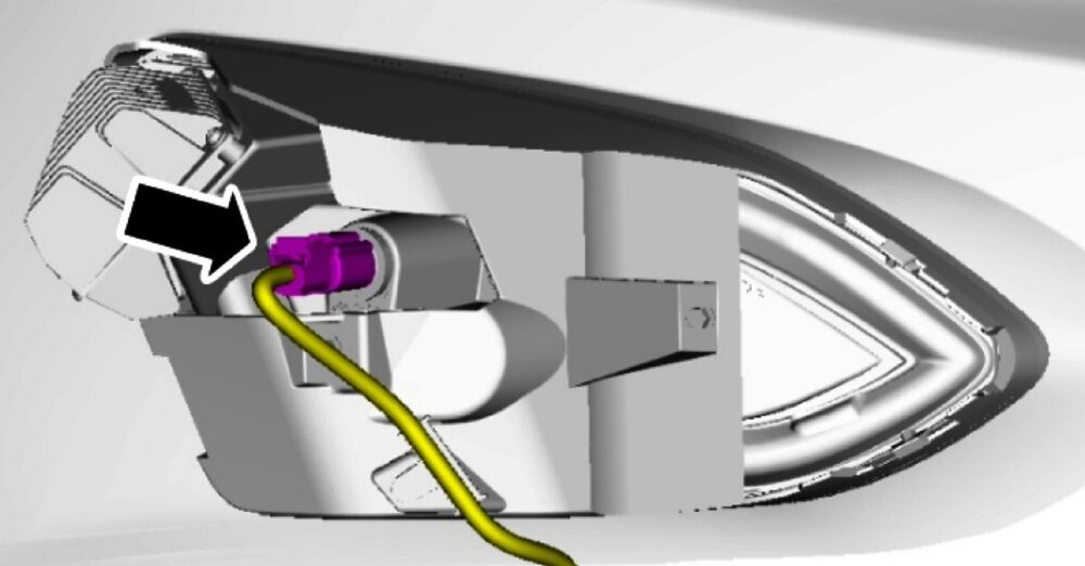

Haz Posted March 27, 2025 Report Share Posted March 27, 2025 The Workshop Manual provides an aiming procedure for headlamps, but offers no aiming procedure for fog lamps. The following Workshop Manual illustration of the fog lamp housing depicts the fog lamp bulb's location, but it's not absolutely clear if this directly coincides with the location of feature you've highlighted above... If it is the same location, then the presumed hex-socketed adjustment screw may actually be a removable plug intended to prevent debris from entering the fog lamp housing prior to installation of the fog lamp bulb. Closer detail of the above-illustrated fog lamp electrical connector is shown in this photo... Workshop Manual procedures relating to removal and installation of the front bumper cover and the fog lamp assembly are attached below as PDF documents... Good luck! Front Fog Lamp - Removal and Installation - 2024 Edge Workshop Manual.pdf Front Bumper Cover - Removal and Installation - 2024 Edge Workshop Manual.pdf 2 Quote Link to comment Share on other sites More sharing options...
