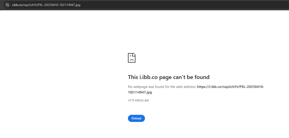

@boostededge - are your photos still available or the links are dead? I can't see the photos. Could you consider updating your post? I have 2022 ST and I'd love to check PTU on mine this summer. Time for full fluid service in my ST:) Thanks!
They still show for me.
https://i.ibb.co/nqz2chYt/PXL-20250410-182114947.jpg
https://i.ibb.co/V0WGVyJP/PXL-20250410-192117856.jpg
https://i.ibb.co/qYxTJ5t9/PXL-20250410-192239964.jpg
https://i.ibb.co/603hHsSw/PXL-20250410-192305765.jpg
https://i.ibb.co/k6WB0c95/PXL-20250410-193054966-MP.jpg
https://i.ibb.co/mVyqJ0hB/PXL-20250410-200603818.jpg
https://i.ibb.co/DHJDLQj3/PXL-20250410-204657626.jpg
https://i.ibb.co/847d6NLW/PXL-20250410-193705384.jpg
  • Sad 1
