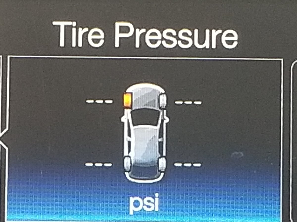

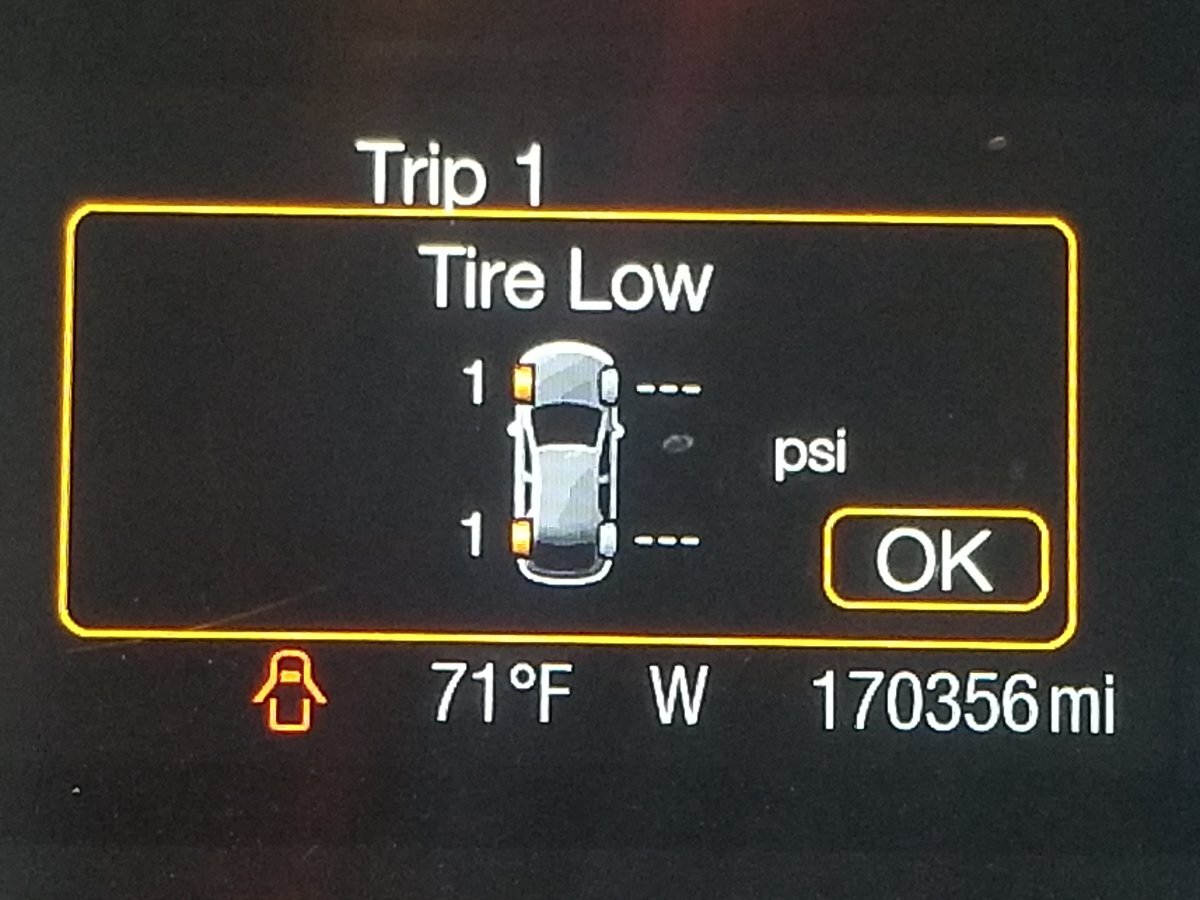

doubleg2582 Posted May 25 Report Share Posted May 25 Does the 2016 edge sel have a tpms reset button? I changed the sensors and have been trying too activate them but the display shows the left front tire has 0 tire pressure and the other 3 tires have dashes next to them. I disconnected the battery and now the left front has the same dashes but the tire is orange. It has the correct tire pressure. Only thing i can think is a possible issure with the sensor. I want to rule everything else out before i change the sensor again. Any imput would be greatly appreciated. 1 Quote Link to comment Share on other sites More sharing options...

doubleg2582 Posted May 28 Author Report Share Posted May 28 Not sure why my text didnt appear with my picture. I purchased the senors from Amazon. I purchased the same sensors a few months earlier for my F150 and had no trouble relearning them. They were preprogrammed and came with a good review. I also purchased the tool to activate the sensors during the relearn process. We recent took a 800 mile toadtrip, the tpms light was on the entire time. We checked all the tire pressures before our trip to be safe. If i dont find a solution to the problem before the weekend, i plan to swap the tires from left to right to see if the problem switches sides. If so then i apparently have a few bad sensors. I know there are several ways to activate the relearn process without a scanner, i chose to use the process that requires you to press the hazard button 3 times. Quote Link to comment Share on other sites More sharing options...
