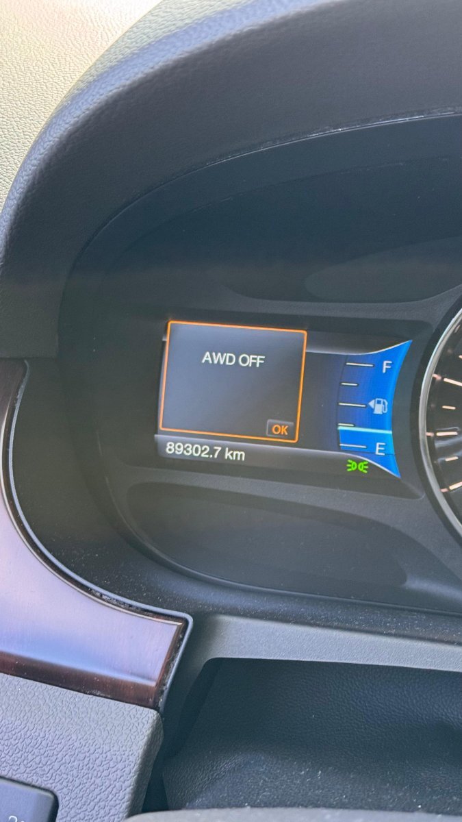

PatrickGuinalia Posted June 7 Report Share Posted June 7 This message appears at random times. As soon as the engine is turned on, or while it is running, whether driving fast or slow. The scanner does not show any error or fault code. The PTU oil was changed a while ago before this problem appeared, so it would not be overheating or anything like that. Does anyone have any idea what could be causing this? And one thing I discovered after a while is that this lag problem in the turn signal only occurs after the AWD off message appears. While it doesn't appear, the turn signals work perfectly. It seems that when the AWD off appears, the entire dashboard lags, turn signals, high and low beams, hazard lights, everything lags/delays. 1 Quote Link to comment Share on other sites More sharing options...

PatrickGuinalia Posted July 4 Author Report Share Posted July 4 As I mentioned before, even though the car has been without starting for more than a whole day, which would obviously make it cold, as soon as I start the engine, the AWD Off error appears. In this case, could it be the PTU temperature sensor? Is there a separate temperature sensor for it that I can examine or buy a new one? I imagine that if there is, it may be sending wrong information to the ECU and it is disabling the AWD thinking that it is overheating, when in fact it is not. Quote Link to comment Share on other sites More sharing options...
PatrickGuinalia Posted October 23 Author Report Share Posted October 23 The AWD was displaying the OFF message because the ABS module with error U3000-49 was causing communication interference on the CAN bus, preventing the wheel speed from being correctly transmitted to the AWD. This caused it to shut down as a protective shutdown. The solution is mentioned in the original post about the ABS module, which I resolved and detailed below. 1 1 Quote Link to comment Share on other sites More sharing options...
