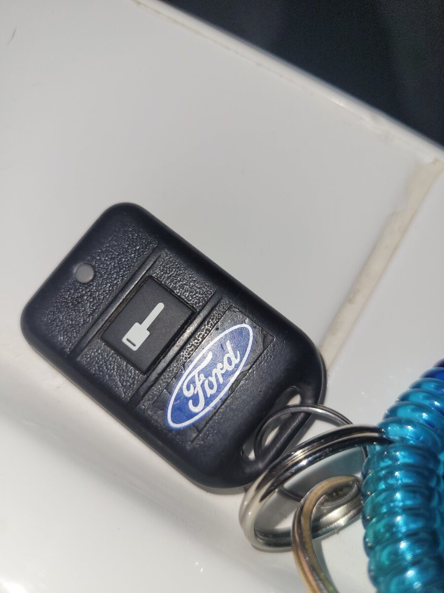

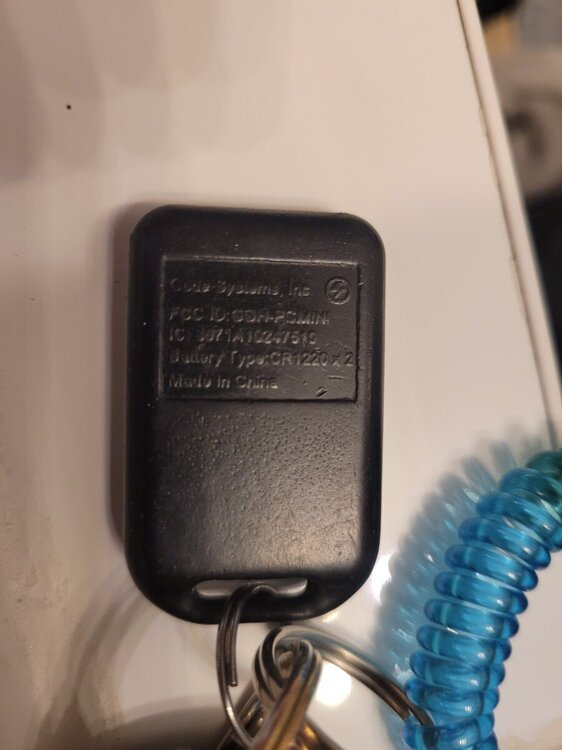

DaBlinky Posted July 4 Report Share Posted July 4 Hello everyone. I recently purchased a 2008 Ford Edge SEL in Canada. I was given a 2nd set of keys, and on them is a Ford Remote starter remote as pictured. On the back it says "Code Systems Inc. GOH-PCMini". However, it does not work or start the vehicle. The light on the remote flashes/lights up (not a dead battery from my understanding). I believe I need to relearn the remote to the vehicle. According to the link below, and the YouTube video below, I need to find the reset/program button on the module. However, I took a good look under the dash (did not remove kick panel), I removed and looked behind the glovebox, and I looked and removed the center console cup holder tray, and I was unable to find the module or reset switch. Does anybody know where this is? I live in Canada, and the dealer wants $250 an hour to try and find it/fix it, which is so much considering I could just put a system in for that price. Here is the Code Systems GOH-PCMini remote program data: https://remotesandkeys.com/blogs/code-alarm/goh-m24-and-goh-mm6-101890-and-elvatkc Quote Link to comment Share on other sites More sharing options...
Haz Posted July 5 Report Share Posted July 5 Welcome to the Forum @DaBlinky! The sales brochure for the 2008 Edge references availability of a remote start system through Ford Accessories, and the 2008 Edge Workshop Manual offers no technical information, indicating that remote start was a non-factory/dealer-installed feature. Attached below as PDF documents are installation instructions and a diagnosis guide for the Ford Accessories system, and also the wiring diagram for the standard starting system, without any remote start system. Good luck! Remote Start Installation Instructions - 2008 Edge-MKX - Ford Accessories.pdf Ford Powercode Remote Start System - Diagnosis Guide.pdf Conventional (No Remote Start) Starting System - Wiring Diagram - 2008 Edge.pdf 1 Quote Link to comment Share on other sites More sharing options...
enigma-2 Posted Monday at 12:06 AM Report Share Posted Monday at 12:06 AM I'll attach the 2008 remote start instructions. May help to pinpoint the components (as well as determining where the problems lies.) (BTW, did you try to hold the remote start button, for a few seconds? It can also be set to double press.) Car locked, all windows up. Hood closed, battery charged. Standing close by? 2008 remote start.pdf Quote Link to comment Share on other sites More sharing options...
