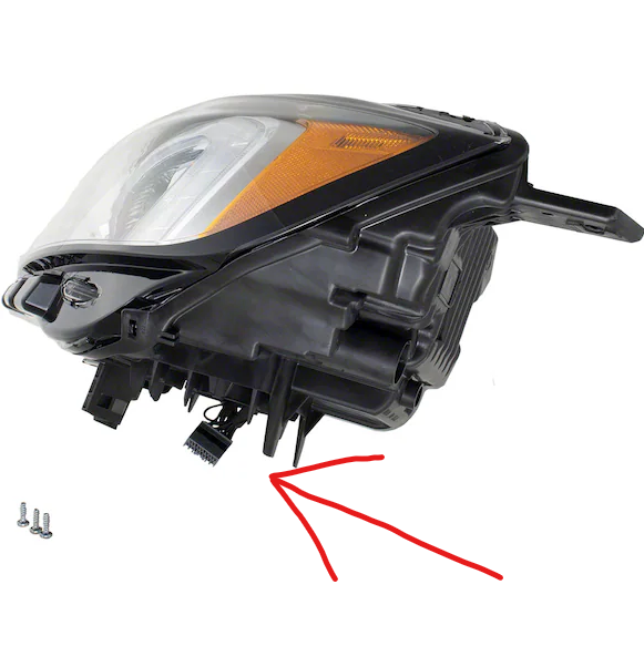

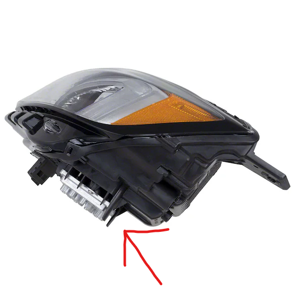

KT4Z-13101-C is only a partial headlight housing. It does not include all parts. It is missing the Lighting Control Module that is the metal box underneath the headlight.
KT4Z-13008-AZ is the composite headlamp assembly. It includes the Lighting Control Module.

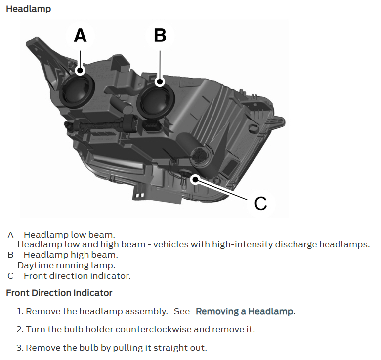

The headlights that you listed are both non adaptive headlights. These headlights should have a dual filament halogen amber bulb. Front direction indicator: WY21W (21 Watts).
What do your headlights look like? Do you have the adaptive headlights? Both part numbers that you listed are for the non adaptive headlights. The non adaptive headlights use halogen bulbs that are replaceable. The adaptive headlights use led turn signals that are not replaceable.
