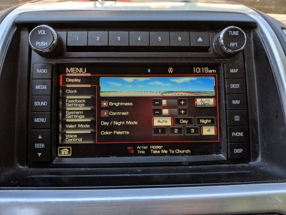

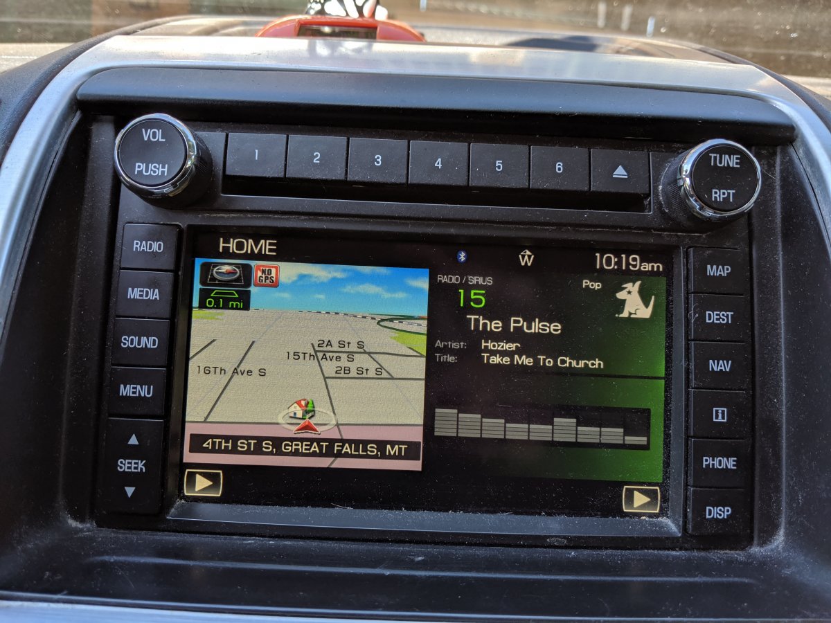

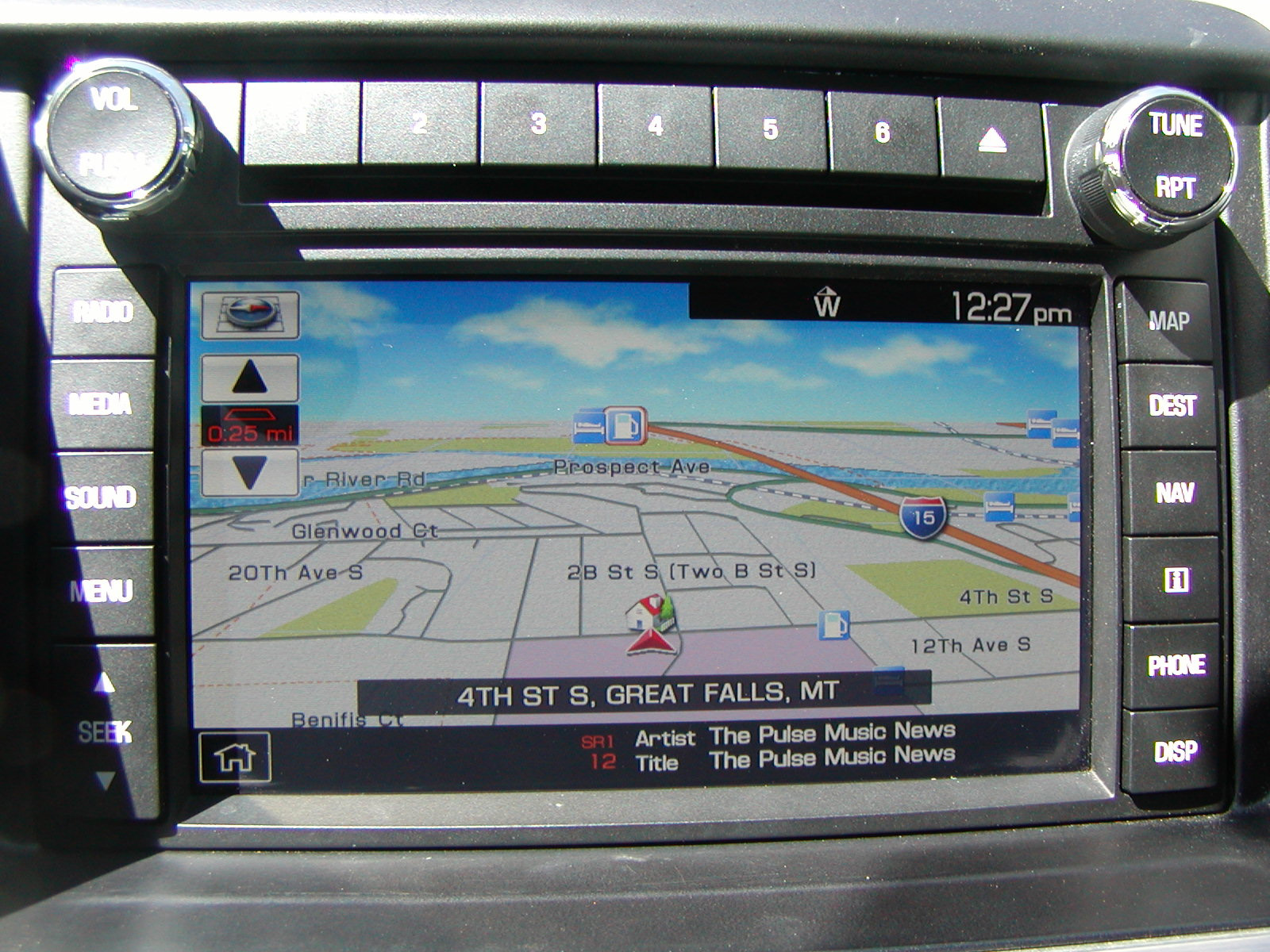

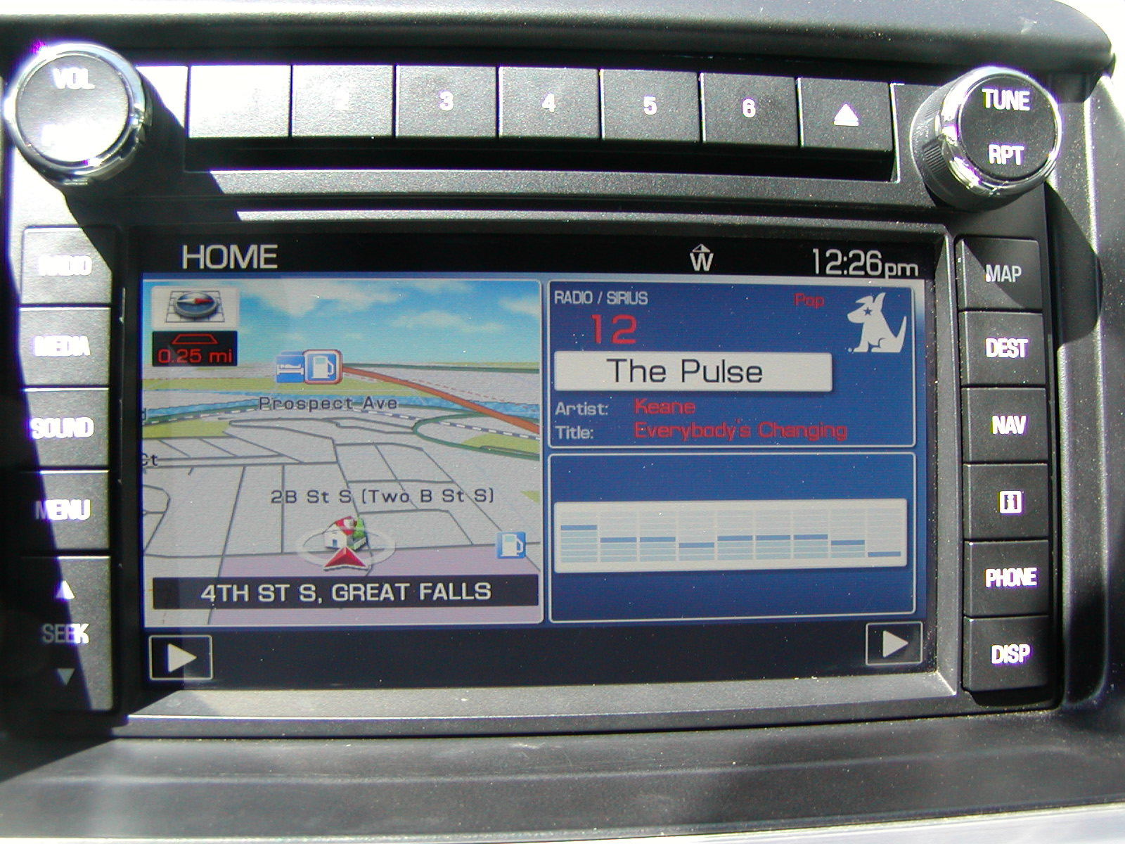

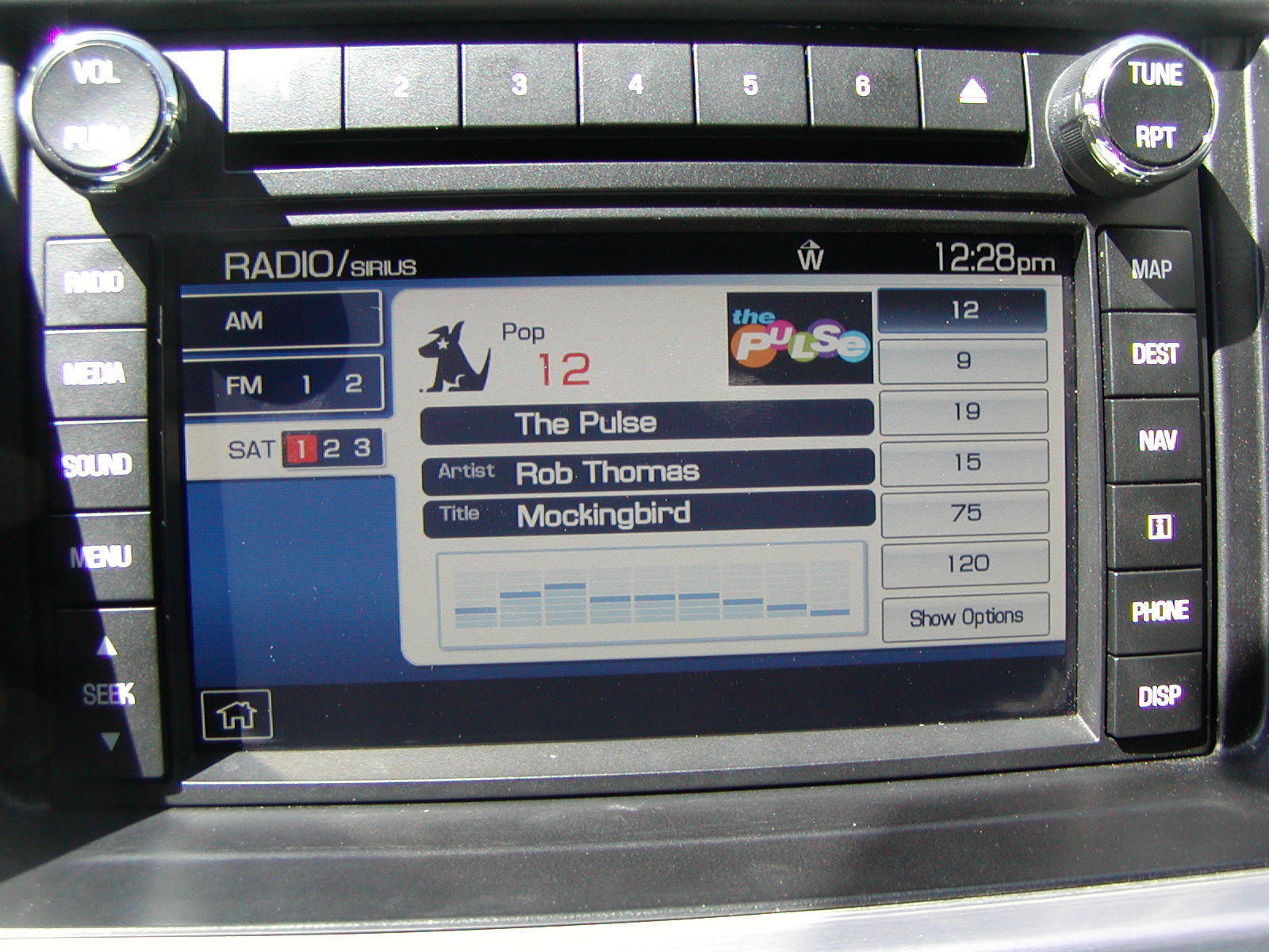

I finally finished installing a 2009 Ford Navigation unit in our 2008 Ford Edge. I am now waiting for the lockpick to hook up the reverse camera.  Changed the as built code to add the color palette option from the Lincoln using Forscan.
