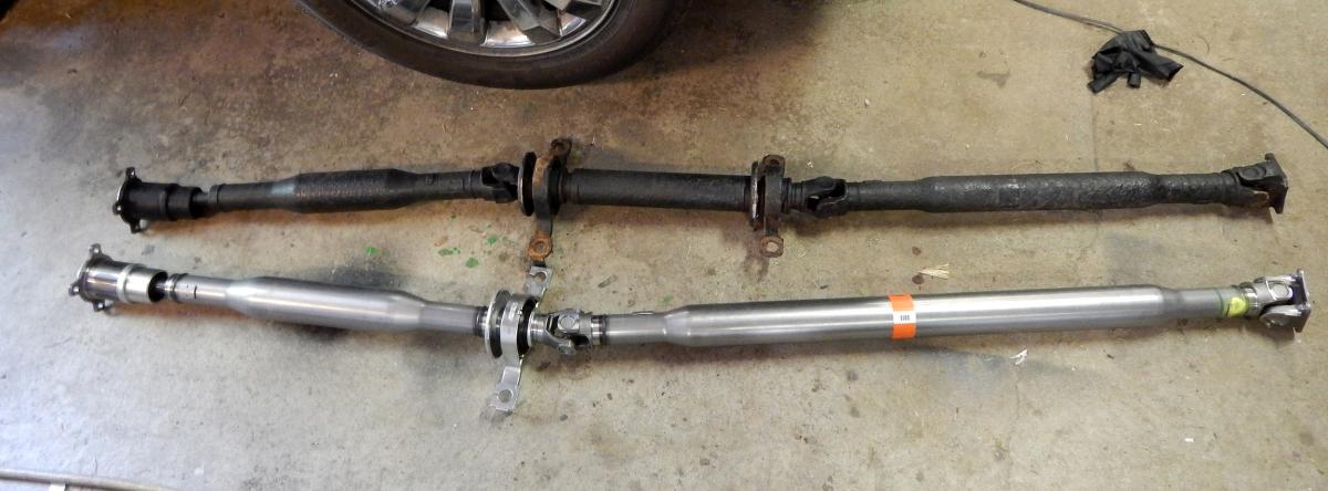

Here's confirmation that the 2 piece propellor shaft/drive shaft bolts right into place on vehicles with the 3-piece driveshaft.  This is the part number of the new one I ordered (hard to find at the moment):  DT4Z-4R602-A.  Apparently it's used on 2009-2013 AWD Edges.  I used the 2 piece driveshaft on my 2007 Edge SEL+  AWD
Shown below in this pic are the two driveshafts side by side.
Attached File  driveshaft.jpg   73.92KB   6 downloads

Any difference in weight/distribution?
