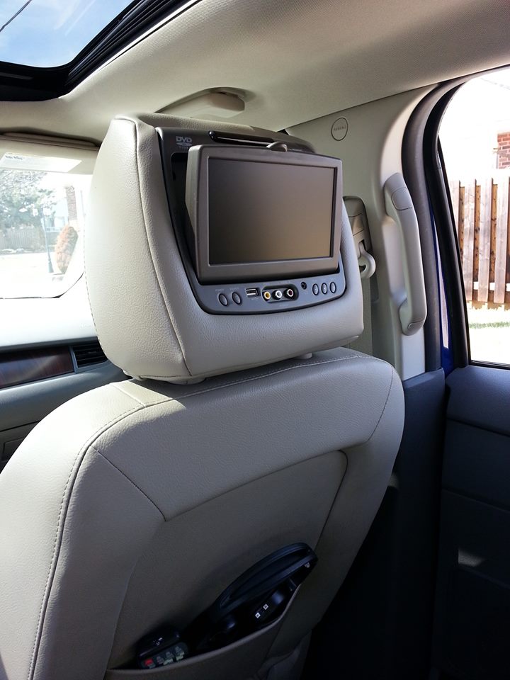

Installed a set of brand new Ford DVD headrests we got for $600 from a Ford dealer. They had ordered the wrong color by accident for a customer. They ordered the black/Sienna instead of the plain black. The wife wanted to get the DVD headrests when we placed the factory order last year, but $2000 is insane. I told her I would eventually put in a cheaper aftermarket system, she was getting on my case to get it done as the travel season is coming. I came across this deal and jumped on it. I had to get the headrests stained to match our medium light stone leather interior color. A local auto upholstery shop did it and it came out looking great. Had a 2 hour road trip and they worked great, the kid loves it. Original color. After stained and installed. -

Got a chance to pull of the kick panels today. The plug to tap into the factory harness is on the drivers side, easy to get at and it will be easy to remove if I ever want to uninstall the system. Not having splice into the factory wires is nice. I'll finish running and hiding the wires another day. Too cold here in Toronto to be fishing wires in a cold car. -

I just bought a brand new in box set of the factory Invision DVD headrests from a Ford dealer for $600. It was an option the wife wanted when we did our factory order, but I refused to pay $2000+. I agreed to eventually find and aftermarket alternative, but this factory set was too good a deal to pass up. I am going to install it myself, it seems simple just from looking at it. The only connection I am unsure of, is where the plug that taps into the factory harness plug for power goes. From the length of the wires it should be one of the kick panels. I was hoping if someone with a factory system can take a peek under their seats and see which direction their power cord goes.
