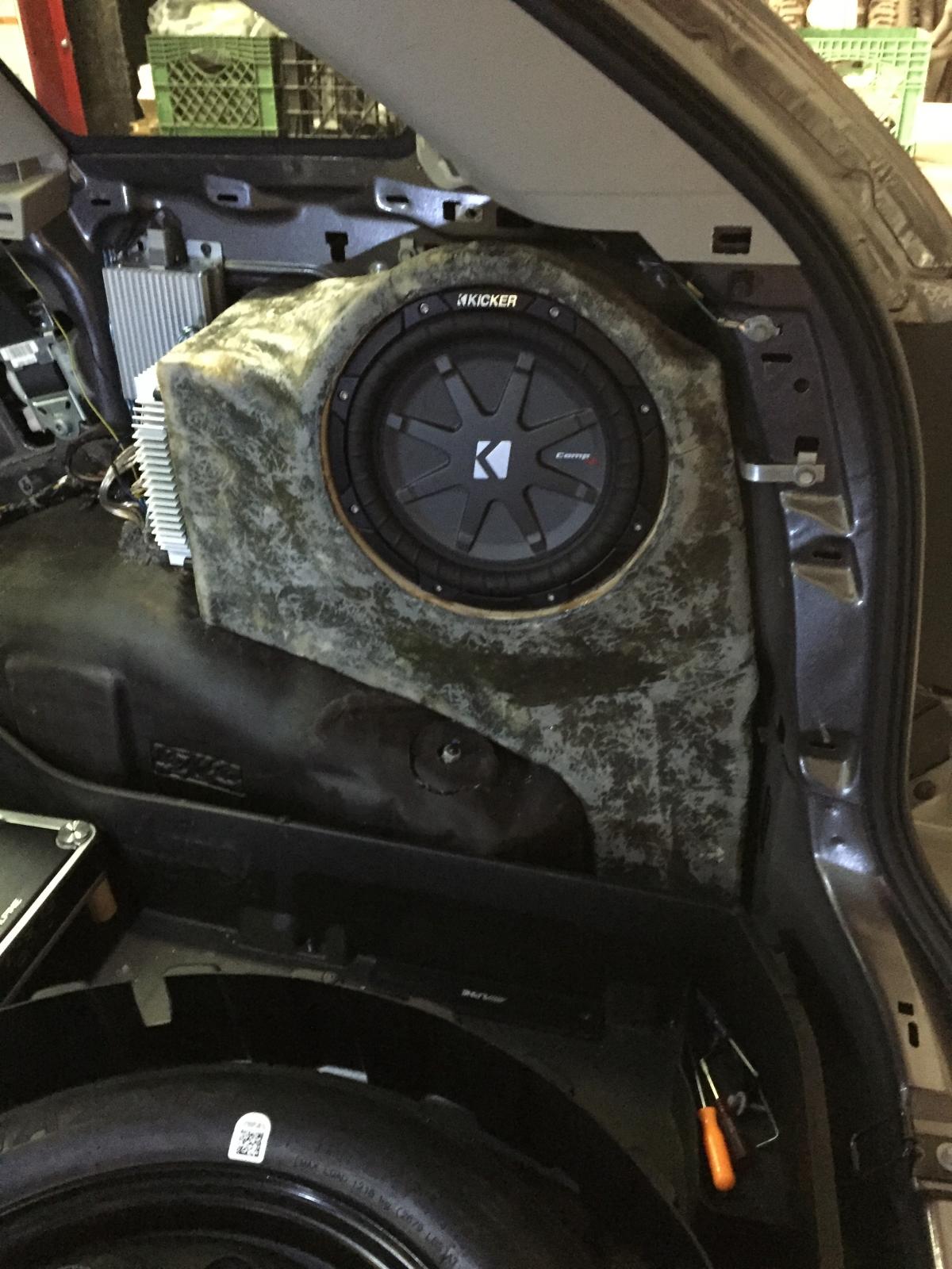

yes Tribby2001 that is the sub amp,i have another box that is next to the factory enclosure. well now it is mounted to my fiberglass enclosure.it is for my sync and i think possibly controls the factory sound processing option on my h/u. idk for sure but i have to keep it as long as i have factory head unit.you can see it here mounted to enclosure and the factory amp is mounted to car.

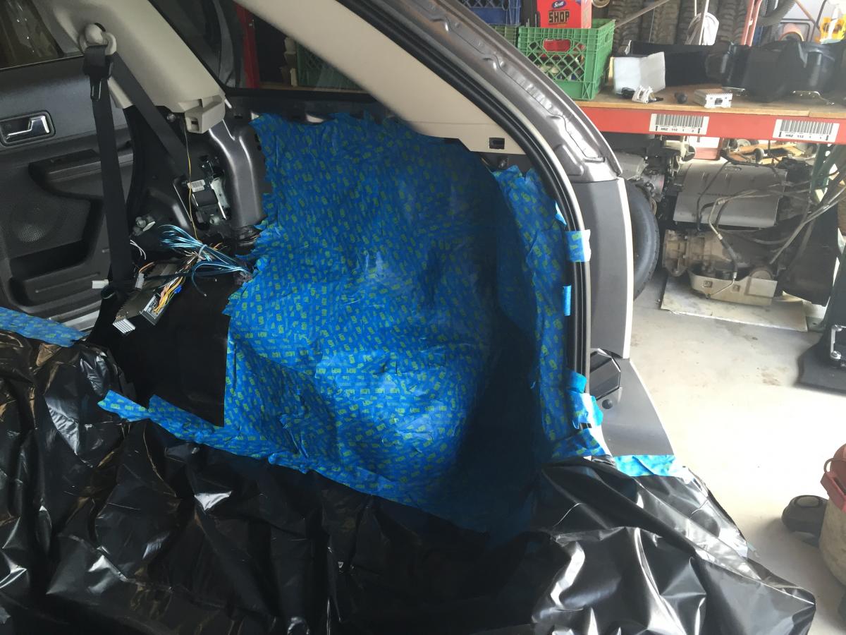

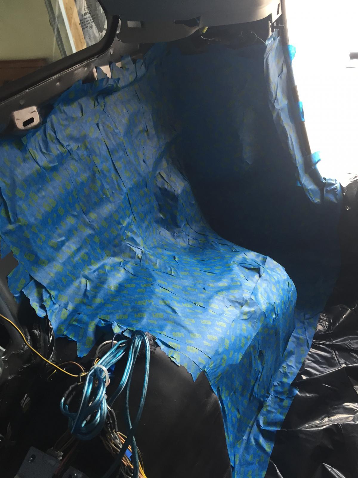

any experience with deadening rattle?

yea they are solid with the factory system.it is after installing audio system that i have a little rattle. it is to be expected though. -

Yea I am finding the peel and seal to be worth not much more than a lesson learned. But I had to start somewhere.it helped some but I don't want any rattle from sub noise AT ALL! I hate nothing more than the sound of a car with a ton of low frequency that sounds like a tin can with rocks bouncing around in it.... You know...the typical BMW from the 80's with the 2 15's in the trunk . No mids or highs and all you hear is the rattle of the car falling apart! -

just curious if anyone has been successful in stopping rattle in passenger rear quarter? my enclosure sits against the metal quarter..i used peal and seal on the back of the body panel and between the enclosure and the inside of the quarter panel...was successful in stopping the brake light rattle with a layer of peel and seal underneath the fixture. just wondering if i will really be able to stop the rattle with the enclosure touching the body. any advice or suggestions are welcome

PrinzII...you should head over here to the west side and you can detail mine too....haha you can check out this enclosure i finished too.i am done with the audio system..just have some more peel and seal to install in the doors. i am honestly surprised as hard as this enclosure hits i dont have much rattle. -

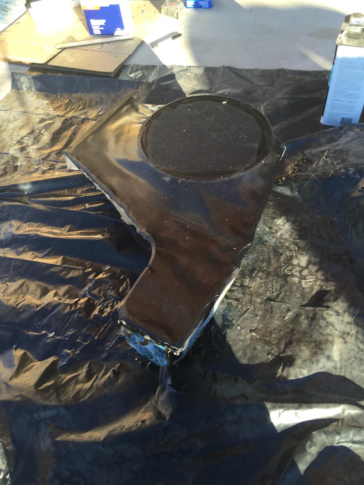

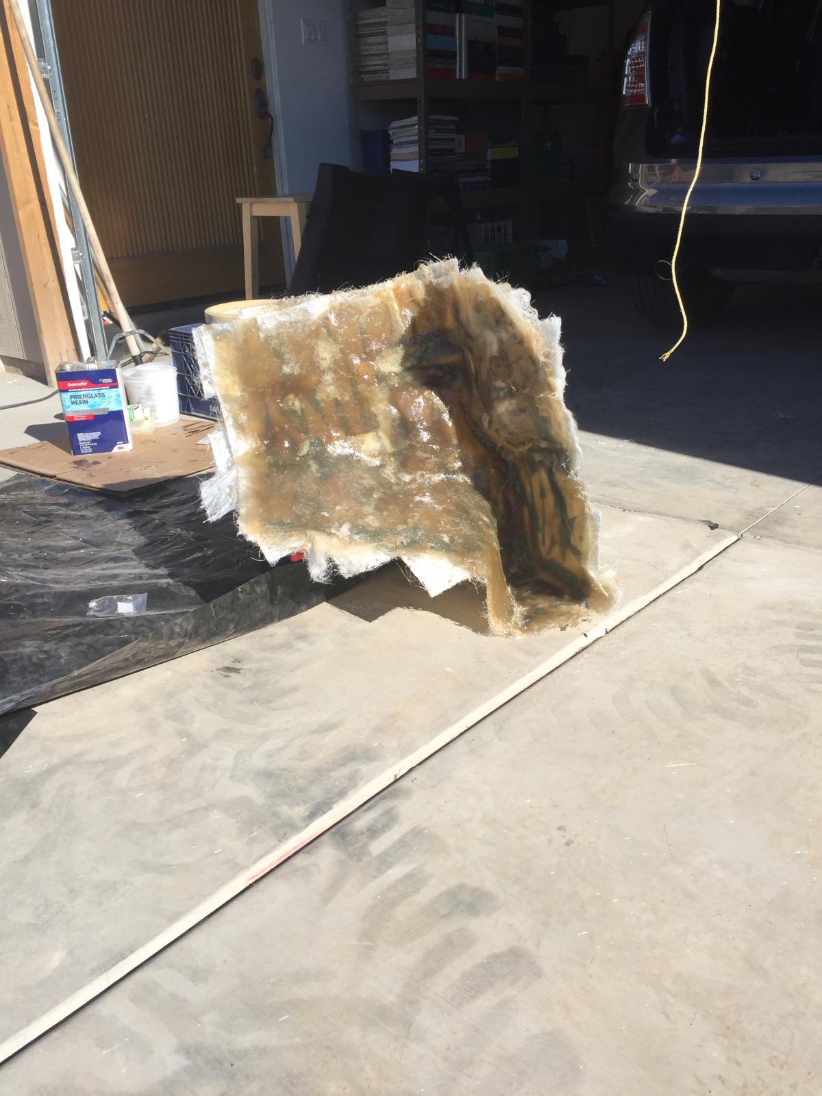

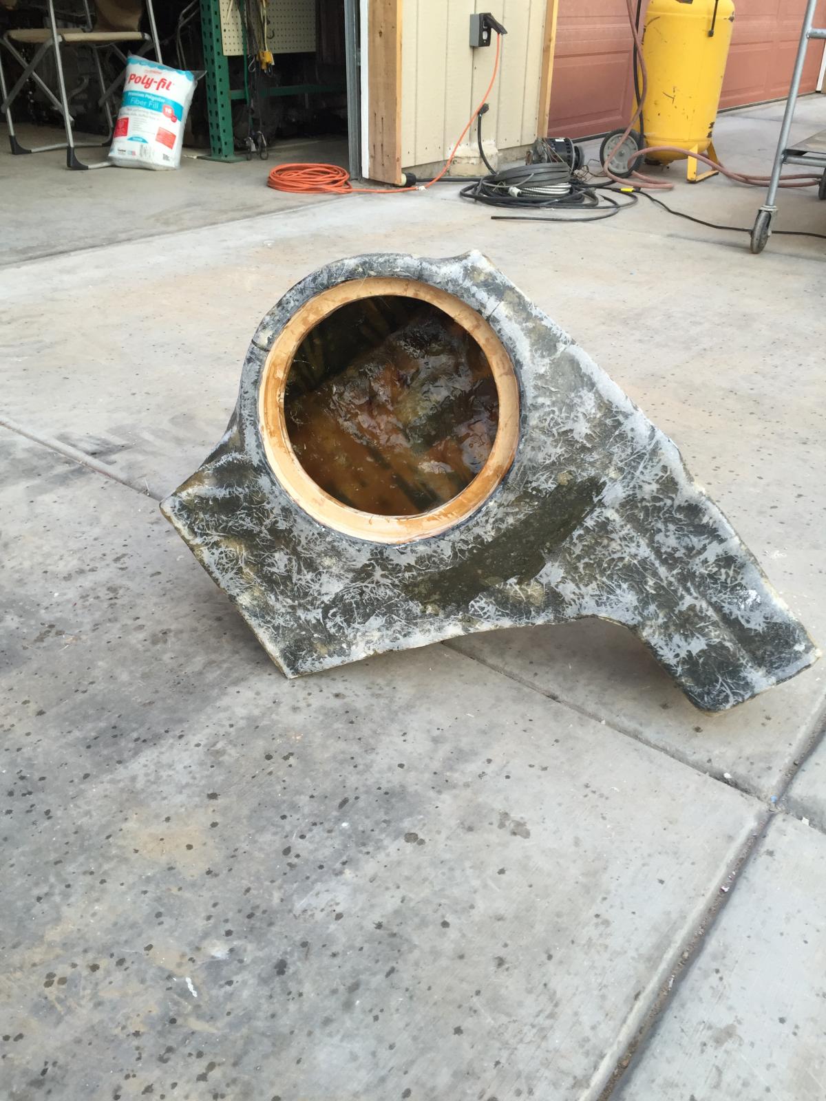

all in all i spent about 15 to 18 hrs total...it was over a couple day period.it is cold here last couple days so not ideal for drying time.definately learned alot by doing this myself..not to mention i saved approx 500 bucks from buying a stealth box..which will never happen .i want to hear the box you have next to the tire happy hour.i am extremely haPPY with the sound from this enclosure
so i modified the factory enclosure to fit a ten and it sounded way better than i thought it wouldbut it was lacking about a 1/2 cf of air space which in a sealed enclosure is alot! not to mention it is made out of plastic so here is my first fiberglass enclosure..learned alot about what to do and not to do during this process. but it turned out well and it sounds exactly like it should...very happy with the results
