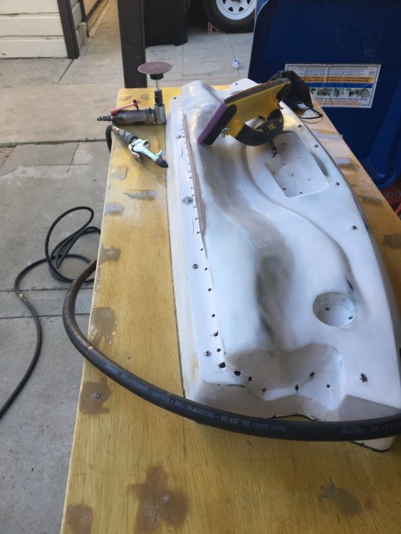

I picked up an air hose coupler from Harbor Freight that allows me to have up to three air tools hooked up at one time. This is a real-time saver not having to swap tools back and forth constantly.

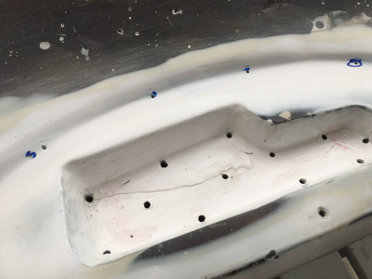

I have added 6 very small vacuum holes along the gasket line to help pull the material into critical areas of the intake. This should help with defining the gasket line and help the overall fit.

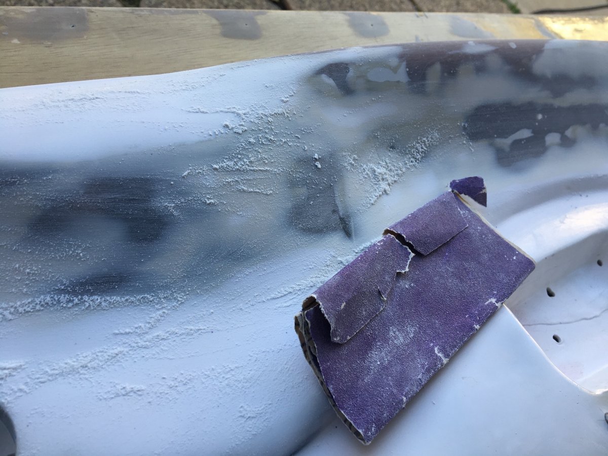

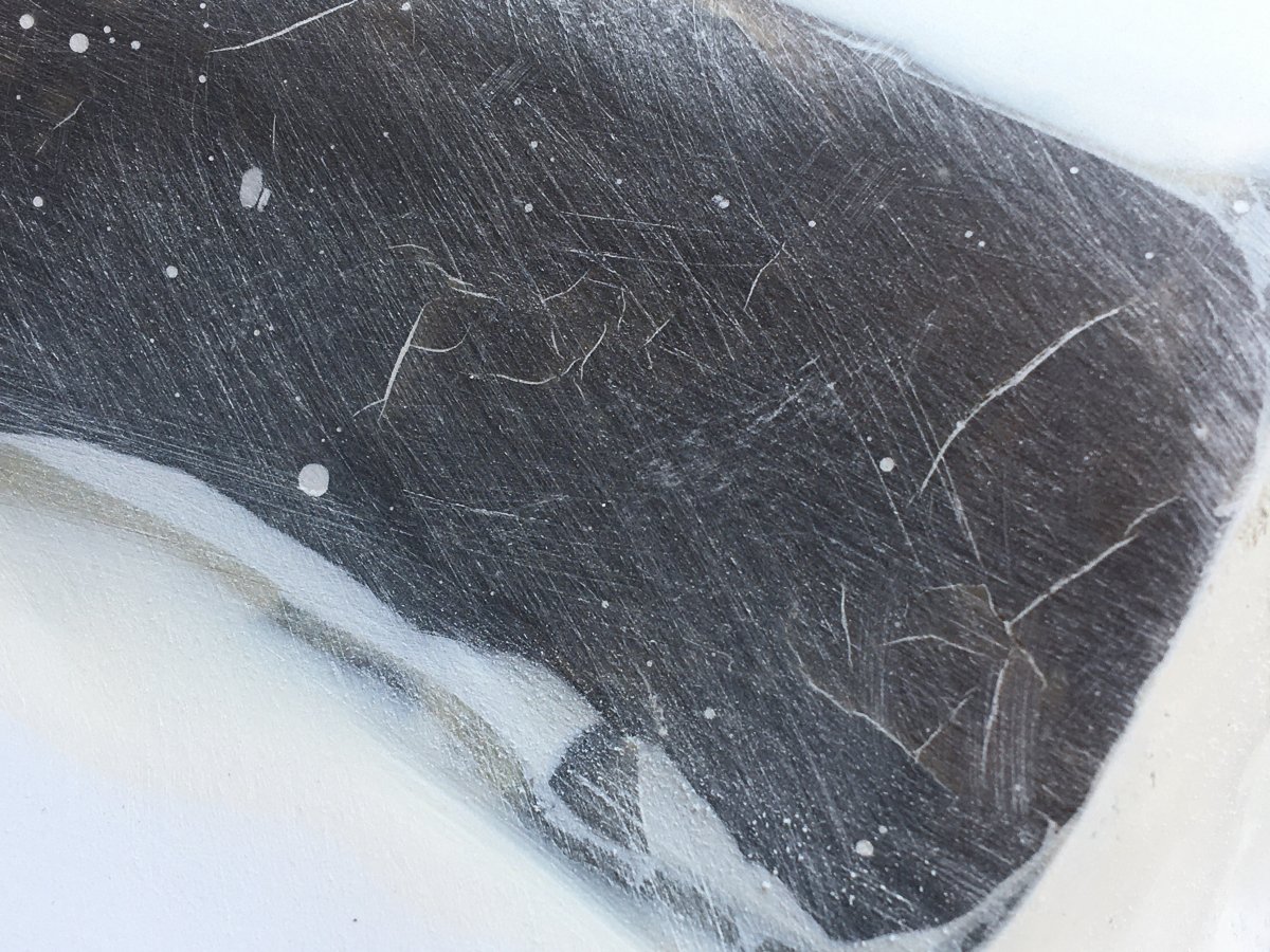

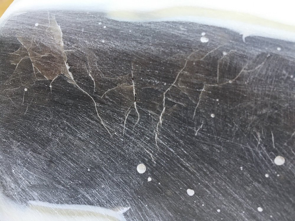

Underneath the nice white finish coat, I discovered that some hairline cracks have formed in the mold. This proves that the mold will have a short life as I originally thought. I believe that it will survive long enough to complete all the orders and a few more beyond that, so no worries, but it is far from permanent.

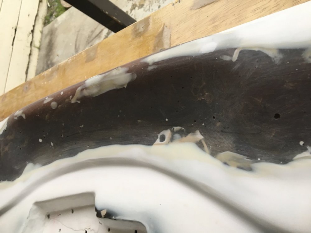

Had to go to the hardware store for more sandpaper today, and work continues. I have removed approximately .125 of an inch so far and will take it down some more to account for the thickness of the finish coat. The Swiss Cheese intake has proved to be very useful in keeping track of progress.

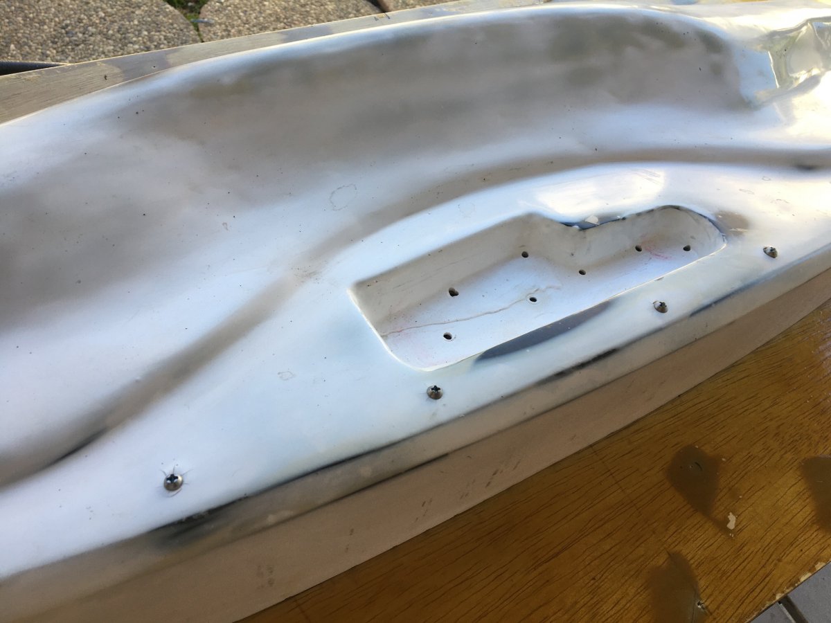

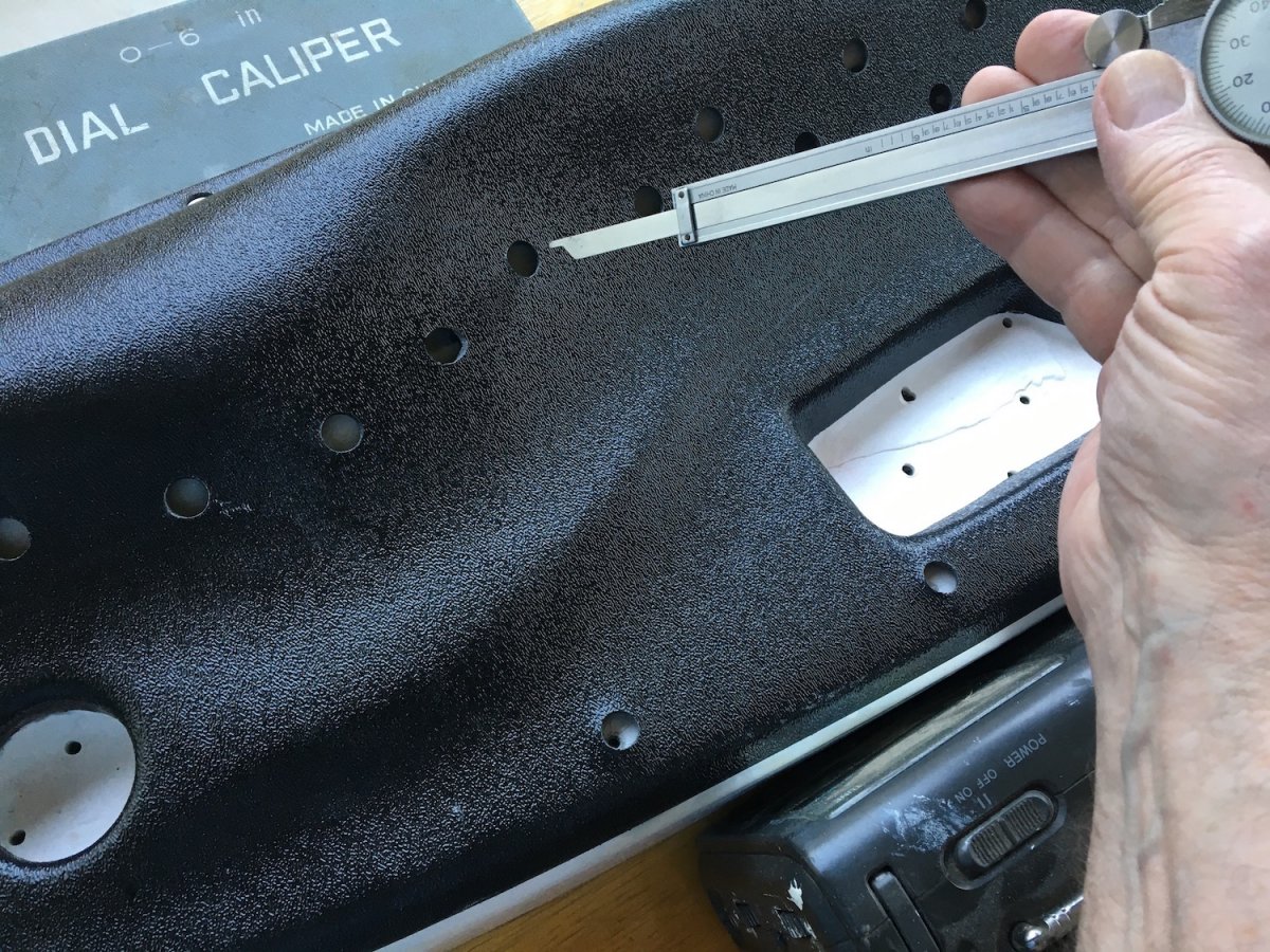

I machined down all 12 of the hole marker screws as much as possible. Even though I had turned them down once before, and it was a huge improvement, the smaller the better. Because of all the contours, hand sanding is the way to go. I Swiss Cheesed one of the intakes to measure how much material was being removed from the mold.

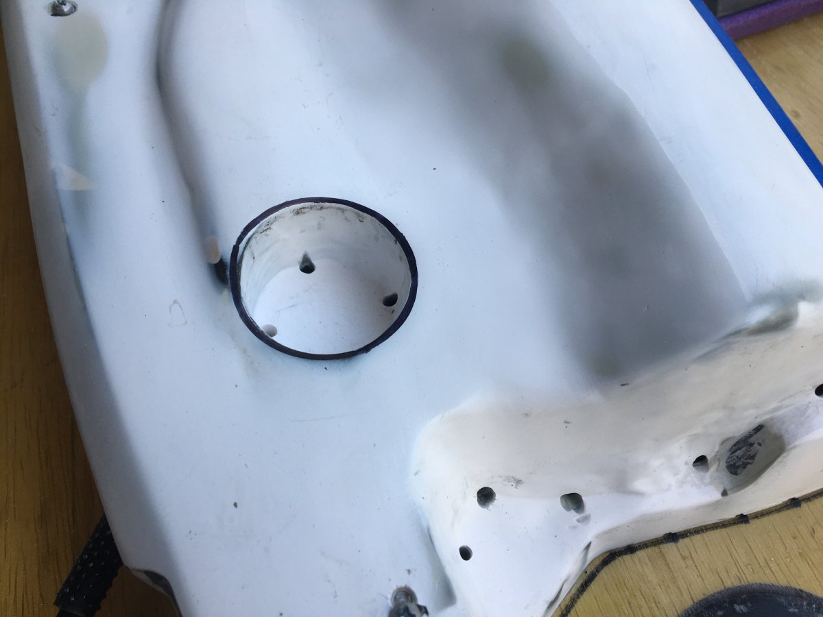

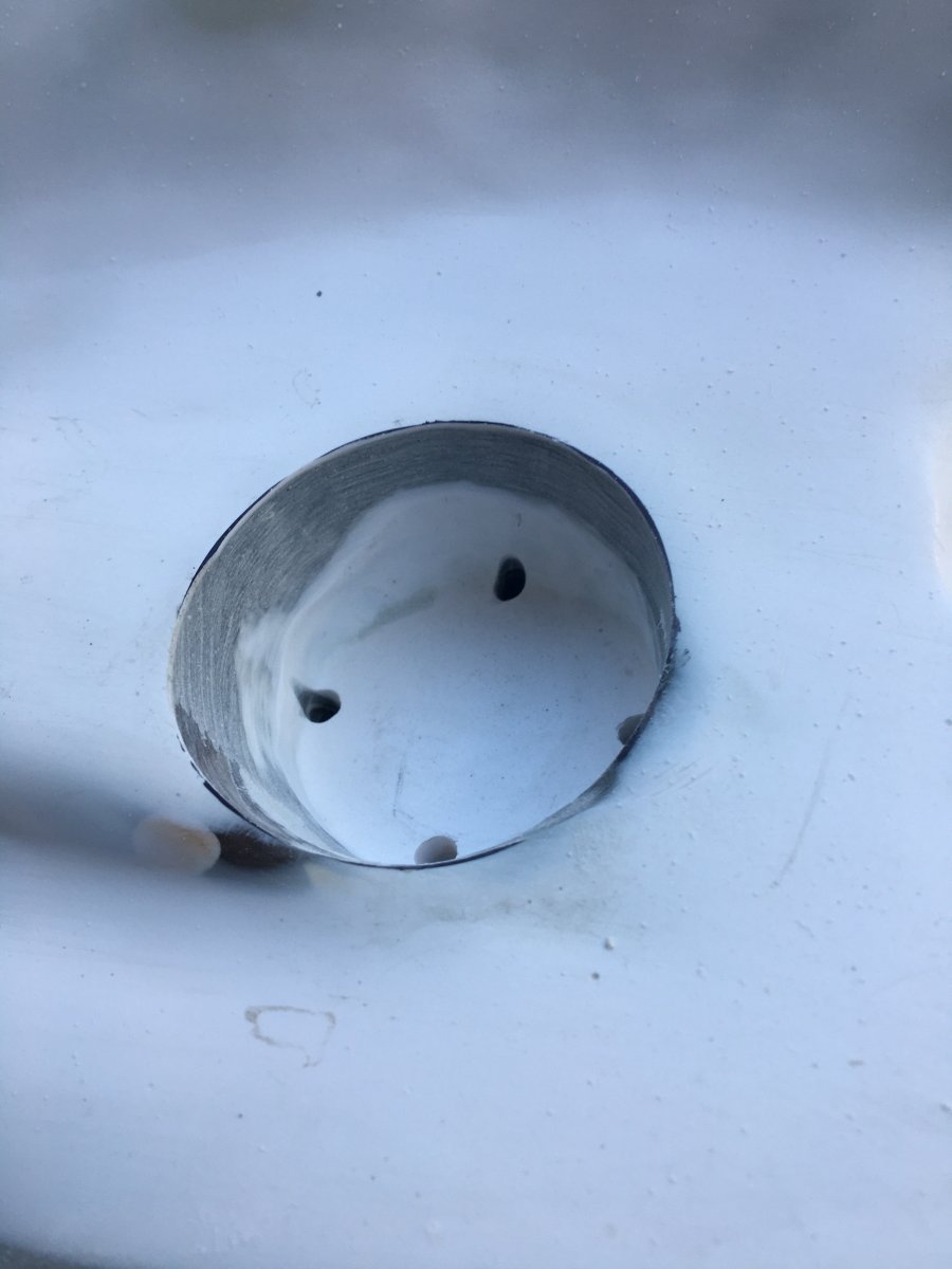

Today I did some more work that the shop requested. In the first photo, you can see the straight sides of the hole. The shop requested that they be tapered some so that the intake would release easier from the mold. The second photo shows the completed mod. Little things like this help.

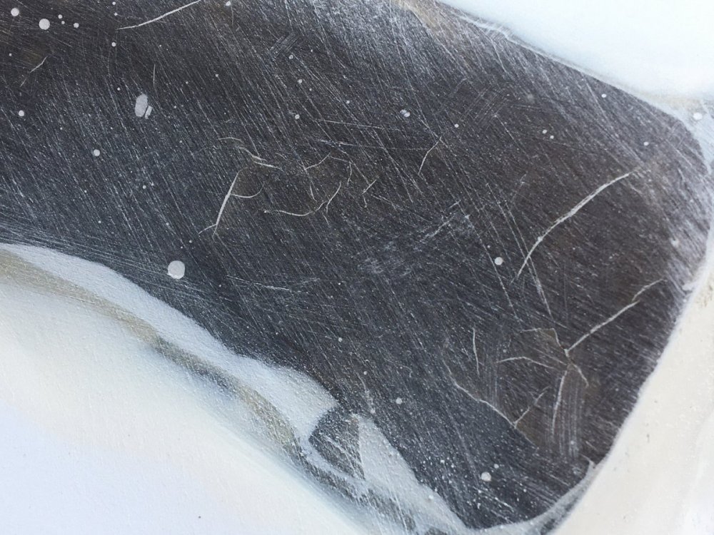

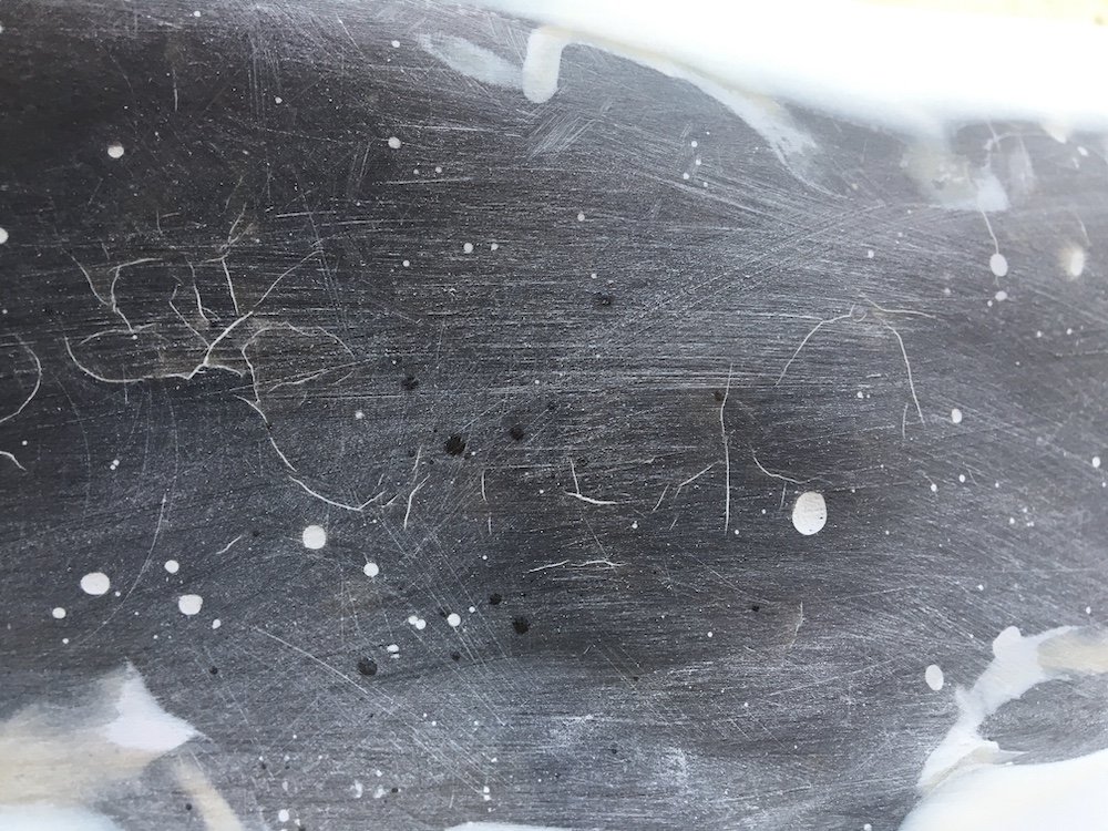

Update 02/04/21: After rough cutting out 5 of the black ABS intakes, I began final fitting them to my car in the hope that they would ship tomorrow, Friday. . As I was testing each and every intake for fit and adjusting as necessary I discovered that there are some problems. First, the tolerance is just too tight and the mold needs to be adjusted so that the intake will fit on other cars besides mine. It appears that the hood can be adjusted a little to achieve a proper fit when the cars are assembled at the factory. This minor adjustment is enough to cause interference with the CAI as no two cars are exactly alike. Second, the mold is not transferring the rubber gasket line to the intake as well as I would like it to. (Check out the photos). This is causing the middle of the intake to be a little bit higher than wanted. The line is clearly visible on the mold, but not on the intake. Both of these problems can be fixed with a little work & TLC on the mold I picked up the mold from the shop today and will begin working on V2 of the intake tomorrow. I had to eat 500 bucks and a bunch of time and work as these first few intakes are not up to my standards. I have stopped taking new orders at this time until I can get these problems sorted, the first few intakes shipped, and get some feedback on their fitment. This project has been full of surprises, challenges, and setbacks from the very start. Why would I think it would be any different now? One thing for sure, when everything is done and working as designed I will be a very happy camper.

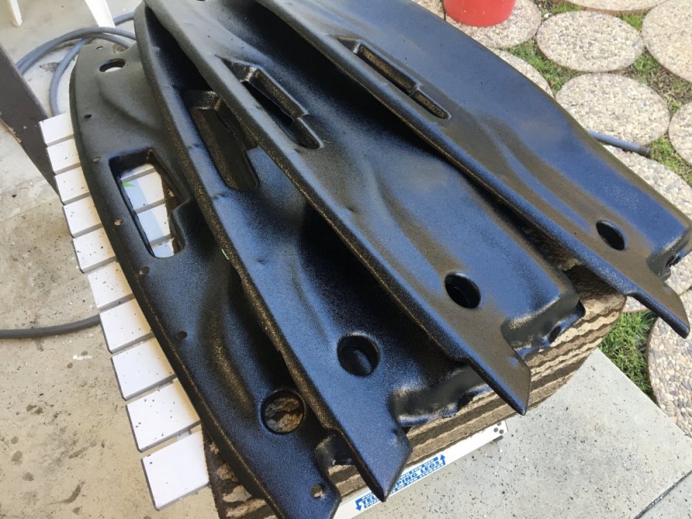

Though I am not ready for a marathon yet, I surprised myself and managed to accomplish more than expected today. I cut a few of the black ABS intakes out, but they still require an hour or so each to drill, hand fit, and finish before shipping.
