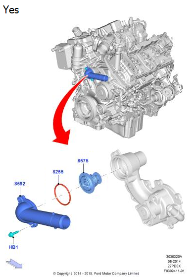

  5. Your description is stating the O-ring goes between the housing and T-stat not like the other pictures through out the post where it is between T-stat and water pump. Correct?

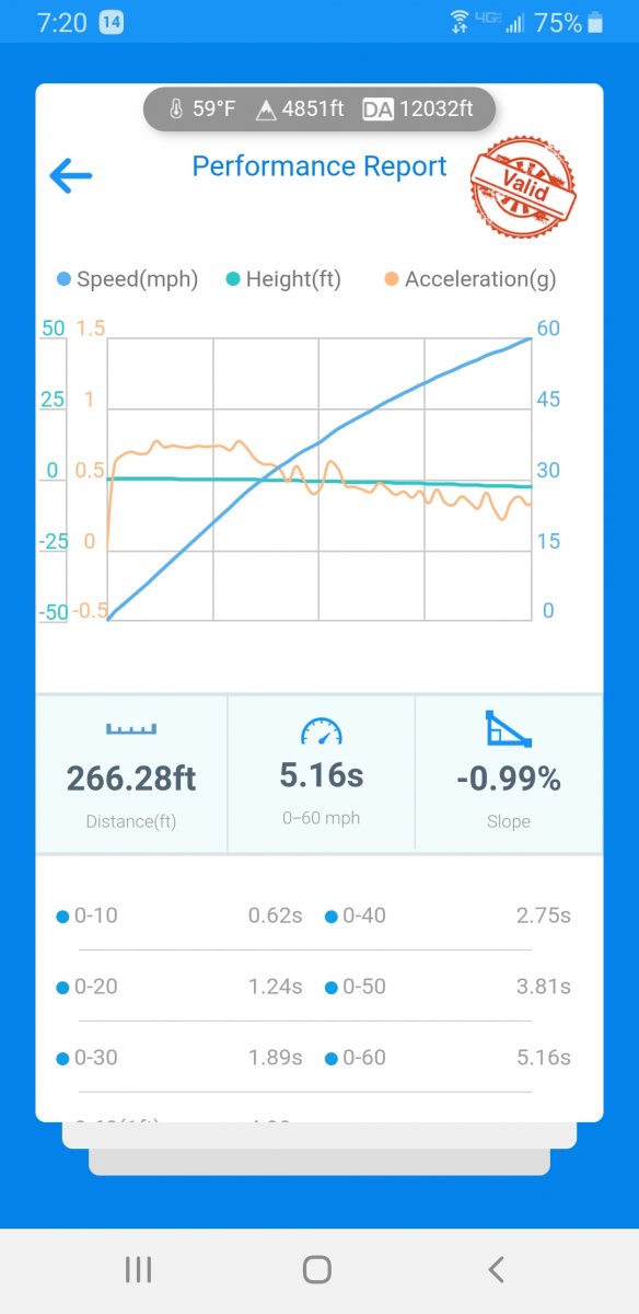

    Just a plug for Livernois. High altitude and low 5s, sometimes high 4s 0-60 with the 91 E30 tune. I've been running this all year and no complaints or problems. Our E85 is set year round to 70%. I'm about to dyno then run a E35 with 94 just to see if there is a difference. It will be a Dyno Dynamics AWD, so no big numbers and prefer non corrected to match my trap MPH. https://drive.google.com/file/d/1dmv4-gRyyh-GUJfxy3y16yAPpeH3KZZy/view?usp=sharing BTW Dragy has F*d up their DA, but altitude is right

  13. I'll add my .02. I've been running the Livernois E30/91 octane tune now for nearly one and a half years with zero issues, except maybe hurting my PTU with over zealous launches when I was figuring out launch points. My shifts are really firm and I would expect and want them to be for a performance tune. If you want buttery smooth imperceptible shifts except for the tach moving, then maybe this hasn't the sophistication for you. I come from the era of nasty cammed 455 cu in backed byTH400s with stout calibrations that knock your fillings out on the shifts. Quick firm shifts used to mean less band wear and faster ETs in my experience. Anyway, I live at a higher altitude, nearly 5000' and race track is 6000. With Draggy 13.3 and high 4 0-60, couple 10ths slower with just the 91 performance tune, I consider great for a 4660 lb family vehicle especially in my location. Livernois has been great answering all my questions and I have tunes from crap 87 to 93/E30 to 100+ race gas. I'm completely satisfied and drive mine everywhere in this tune. I understand more is better, too much is not enough for some, and fully support anyone wanting to go faster. I would think when you cross the line from stock tuning to aftermarket bigger and better, upgrading to a custom hands on dyno tune should be part of the plan. I'm hoping to find a reasonable dyno day to get comparative numbers for myself.

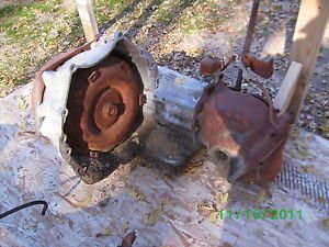

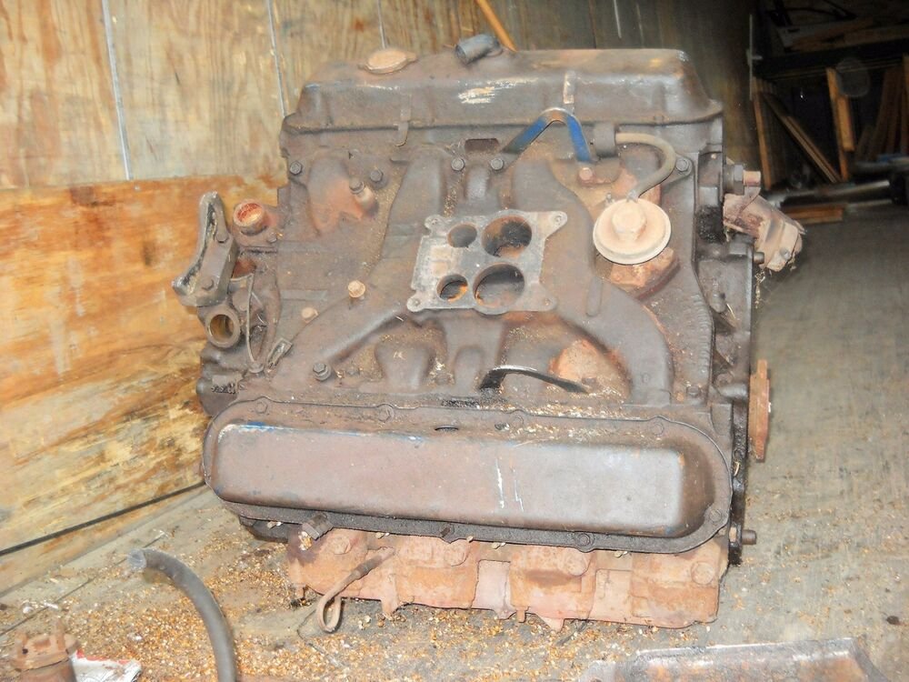

  15. My engine blew last night right after blowing the doors off a pesky McClaren. I decided to swap in an old Cadillac 500 I had sitting by the shed along with a 67 Olds Toronado TH400 to maintain the FWD. Handling and power is soooooo much improved. Happy April, stay safe and healthy.
