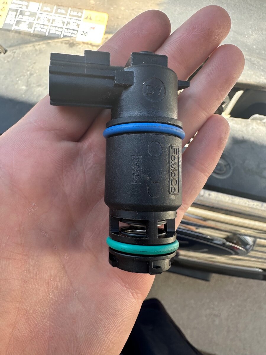

  8. Good callout on the stop/start accumulator. The solenoid on mine wasn't loose, but the seals on the solenoid pooped the bed and puked fluid in my driveway. Easy to replace yourself.
