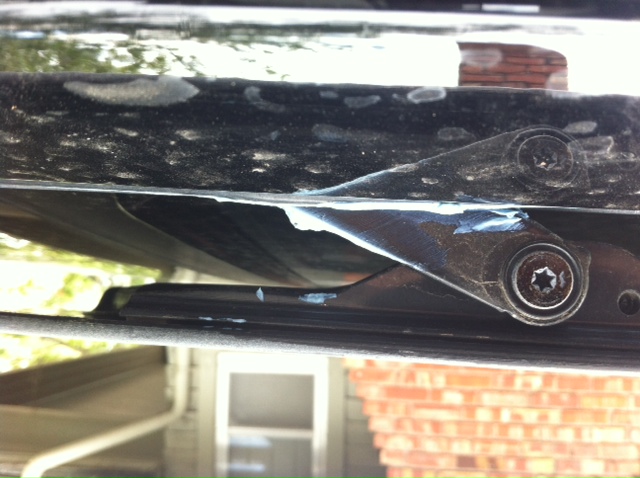

My 2011 Vista Roof would drag to a halt before closing. I would have to help it to close. The service dpt seems to have fixed the issue with a healthy dose of blue grease. EDIT: Excuse the odd rotations of the photos. Pic 1 is upside down. Pic 2 is is 90d off
