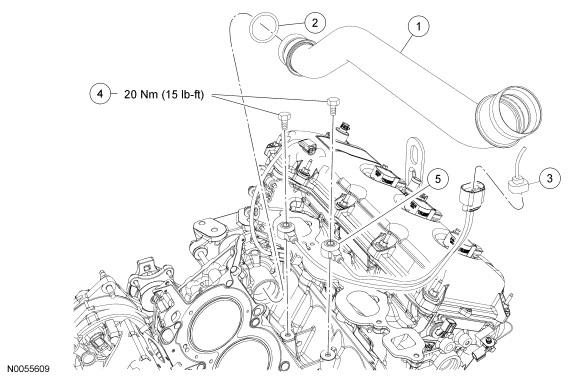

Hello i'm new here my question is where is located the knock sensor in the edge 3.5 thank you
Here's a diagram:
Item Part Number Description
1 9N271 Coolant tube
2 8565 O-ring
3 14A464 Knock sensor (KS) electrical connector
4 W500310 KS bolt (2 required)
5 12A699 KS
