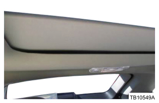

1.Inspect the headliner for sagging at the roof opening panel near the overhead lamp. Is the headliner sagging? (Figure 1)
Figure 1 – 14-0088
a.No – this article does not apply.
b.Yes – proceed to Step 2.

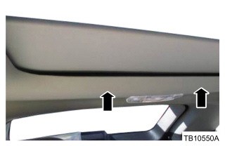

2.Apply upward pressure to the headline for 45 seconds to eliminate the sag condition. Allow the vehicle to sit for 30 minutes. (Figure 2)
Figure 2 – 14-0088
3.Did the headliner stay in place?
a.Yes – no further action is required. Return the vehicle to the customer.
b.No – replace the headliner. Refer to Workshop Manual (WSM), Section 501-05.
