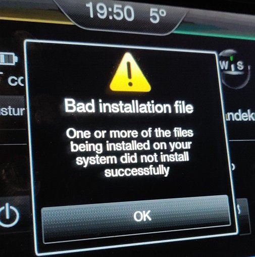

MyFordTouch SYNC2 – UPDATE FAILS – BAD INSTALLATION FILES – A SOLUTION

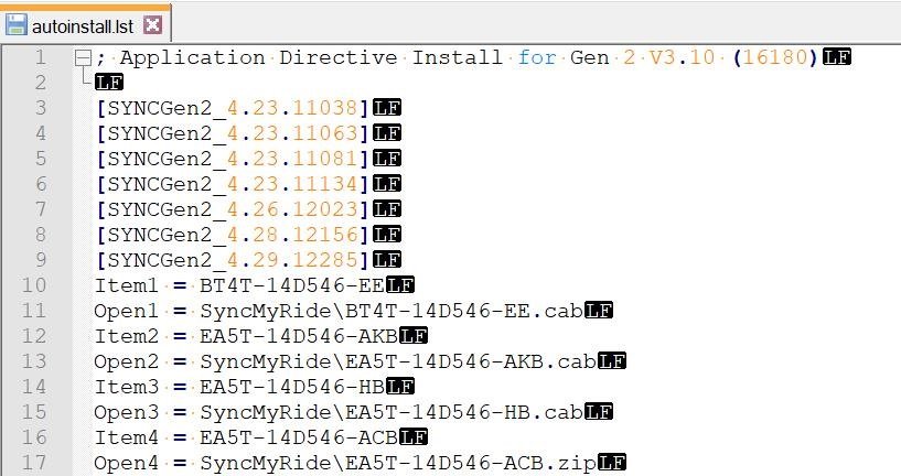

When you download the installation Zip file and extract it, you have 2 files and 1 directory (which contains all the installation information).  The only one file to be concerned about is the "autoinstall.lst" which tells the software what to do and in which order.  This file does not comply with the format that windows require in order to be executed (or read, for that matter).  It is missing what I would call a "hard coded CARRIAGE RETURN (CR)". To rectify this you need an editor other than "Notepad" which comes with Windows.

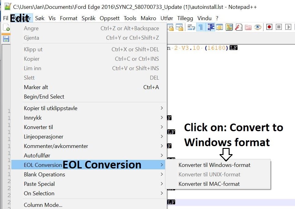

You can download a program named "Notepad ++" free from the internet.  Once installed on your computer open it and then open the "autoinstall.lst".  In the editing window you will see that behind each line there is a "LF" (Line Feed).  Navigate to Edit on the menu bar and click on it.  In the expanded menu, search downwards and find "EOL Conversions", then click on it and you will find 3 submenus;
Convert to Windows-format
Convert to Unix-format
Convert to MAC-format
The "Convert to Unix-format" is greyed out, indicating this is the current format.

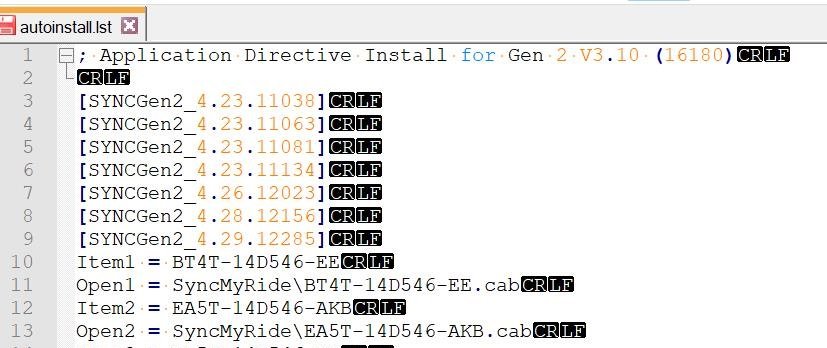

Highlight "Convert to Windows-format" and click on it.  You will see that the lines in the editing window now have changed their appearance.  All lines end now with "CR LF".
Save the file on top of the old "autoinstall.lst" and you are ready to start the installation.
