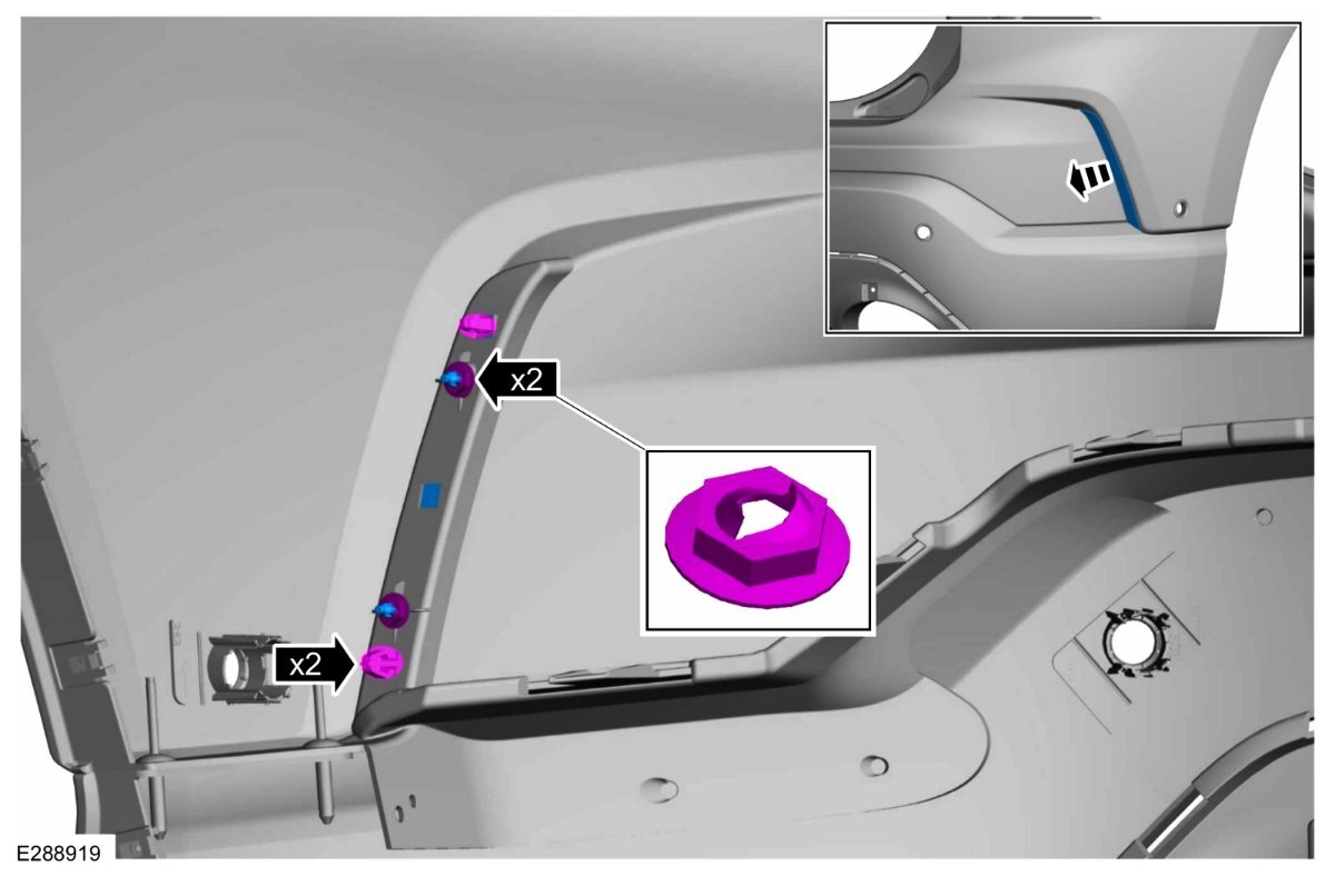

From the 2022-2024 Edge Workshop Manual, and attached below as PDF documents...
Good luck!
  1. On both sides.
    Remove the push nuts, release the tabs and remove the rear reflector.
ENHANCEDIMAGE-RearBumperCover-DisassemblyandAssembly-2022-2024EdgeWorkshopManual.thumb.jpg.da2bd21064d57a7884301ca664619f1d.jpg
Rear Lamp Assembly - Removal and Installation - 2022-2024 Edge Workshop Manual.pdf Rear Bumper Cover - Removal and Installation - 2022-2024 Edge Workshop Manual.pdf Rear Bumper Cover - Disassembly and Assembly - 2022-2024 Edge Workshop Manual.pdf
  • Thanks 1

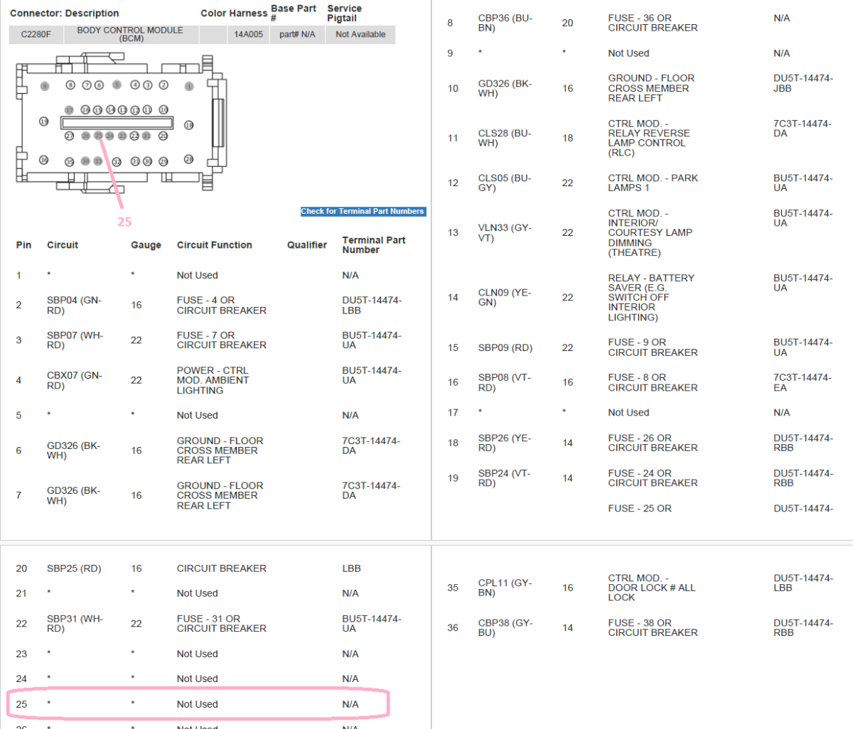

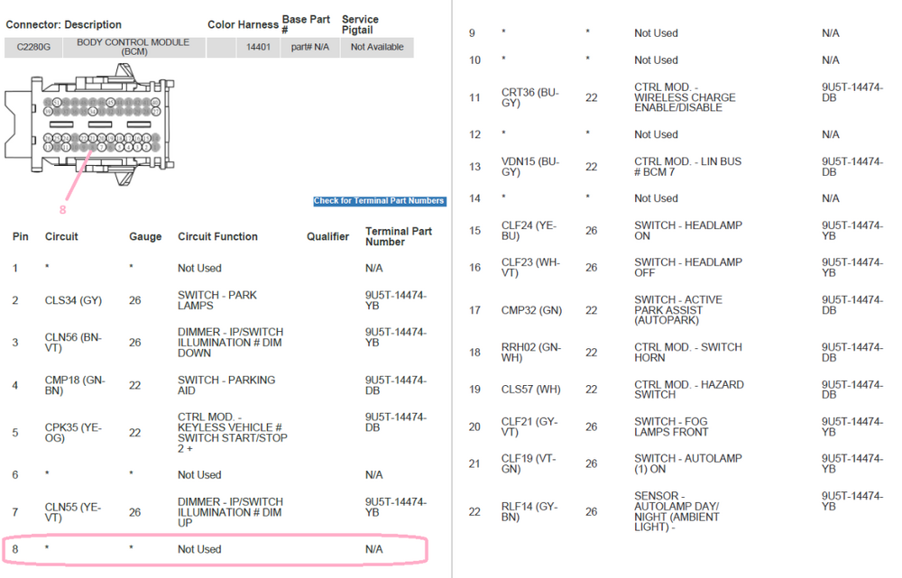

Story continues: analyzing wiring schematics from @Haz and comparing with Service Manual i have - built based on my Edge ST VIN.
Steps to be followed as per my understanding:
1. Install light switch module ( HEADLAMP SWITCH) with one that has rear fog switch button. Already done.

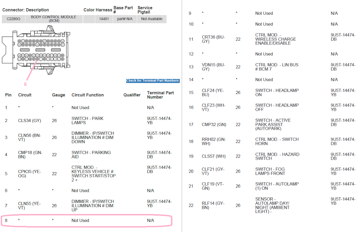

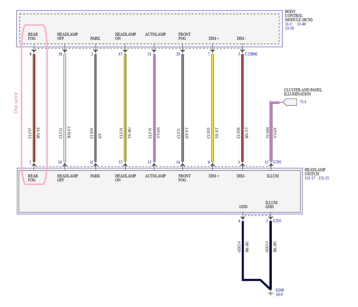

2. check if wire (CLF57) connecting HEADLAMP SWITCH module, pin 2 (REAR FOG) is in place and go to BCM pin 8 (REAR FOG).
     What if there is no wire? To run a wire is not a problem from HEADLAMP SWITCH side. But how about BCM side? My VIN based Service Manual says BCM C2280G connector pin 8 is "not used". If there is no metal contact there then what? If it is only about putting metal pins in the connector (harness side) and crimp a wire then the question is - where to get suitable pin from? If BCM side pin is missing then... Don't tell me i have to take the whole BCM out of the car, open it and solder/whatever new connection inside:) Then another question to you guys - how the heck to take it out? Or even how to have some access to BCM? I saw BCM during installation of HEADLAMP SWITCH - it is so deep under the dash and there is zero room for hands not mentioning any manipulation around connectors!

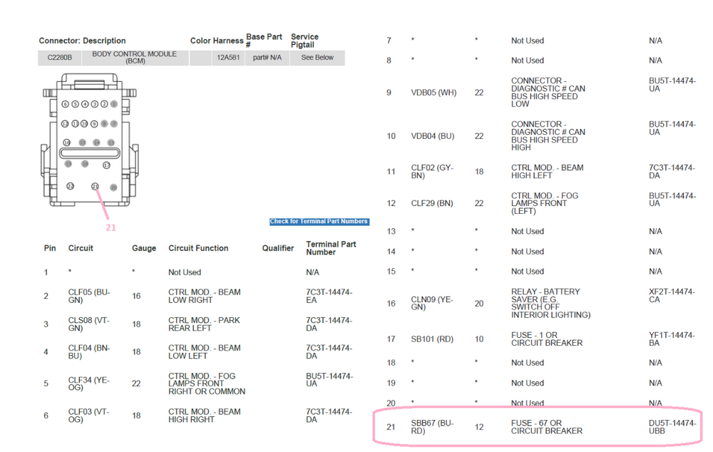

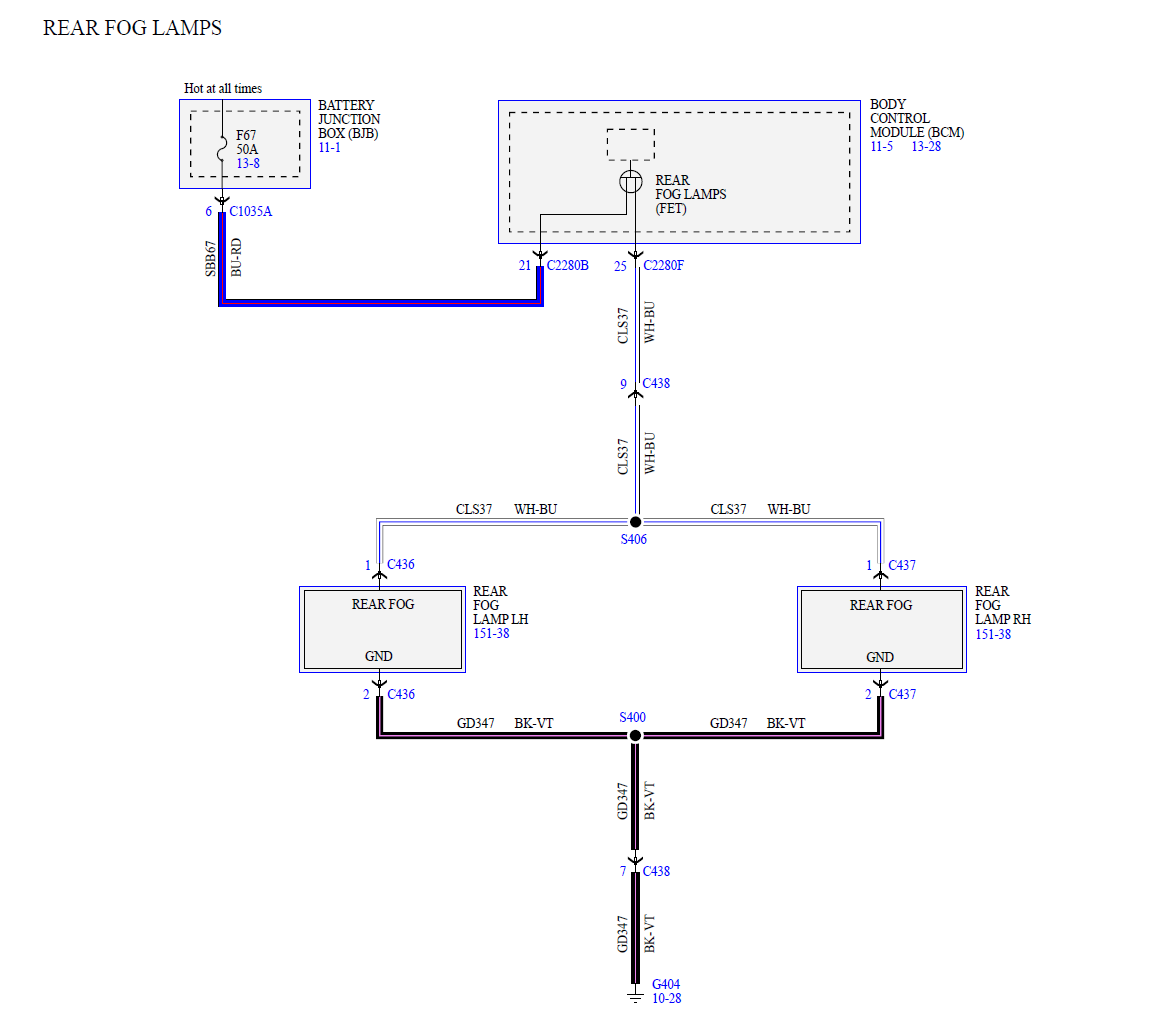

3. Check if there is wire (SBB67) going from BATTERY JUNCTION BOX connector C1035A, pin 6, to BCM connector C2280B, pin 21:
By looking at the wiring schematic it looks like this wire (SBB67) is specific for REAR FOG lamps - is it truth? But then 50 Amps fuse?! Or maybe this schematic is simplified and inside BCM this wire powers more things?

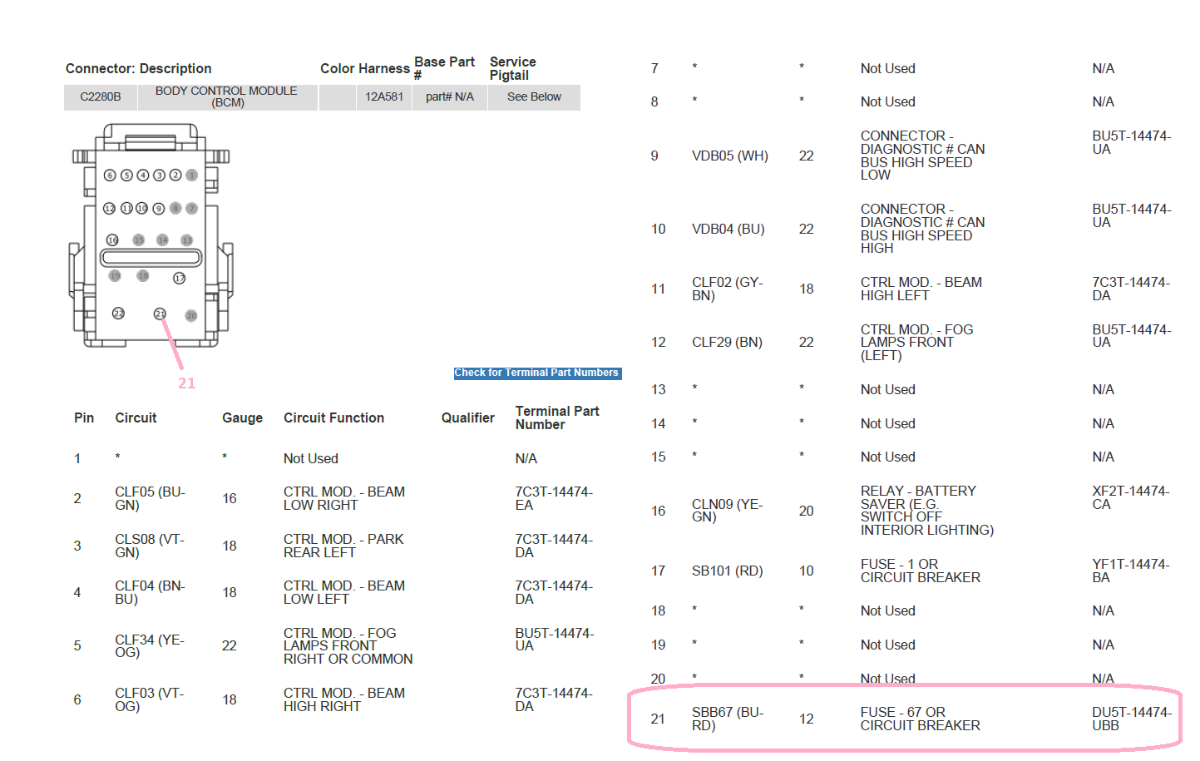

At least I'm bit positive here and my VIN based Service Manual shows C2280B bin is occupied:
4. Check is there is, if not, run new wire from BCM connector C2280F, pin 25, all the way to the back of the car to connector C438 (if exist...) and to DIY lamps - do it yourself as i haven't found OEM lamps that fit in place of original reflectors in my bumper (USA ST, 2022):( Then the other wire (negative) to some ground point in the back.
And here again, my VIN based Service Manual shows BCM connector C2280F, pin 25 is not used:
...so the same question on how to install it:/
5. Adapting the whole system to make it work - will it work straight away after the connections are made or some adaptation/programming is necessary? ForScan - how, what modules, etc - but for the moment i need to win points 1-4...

Please put some light on the topics highlighted above. Those missing wires and empty slots in BCM worries me the most.
Thanks!
You do not need to remove the BCM or solder anything. Instead, to add a wire, you unplug the connector from the BCM, then you can take apart the connector, and push a new pin into it. You can access the BCM by reaching up under the dash, and you can remove the small cover in the front that is right below the headlamp switch.
Program with FORScan. Changes in BCM to enable rear fog lights. And IPC to enable the indicator.
