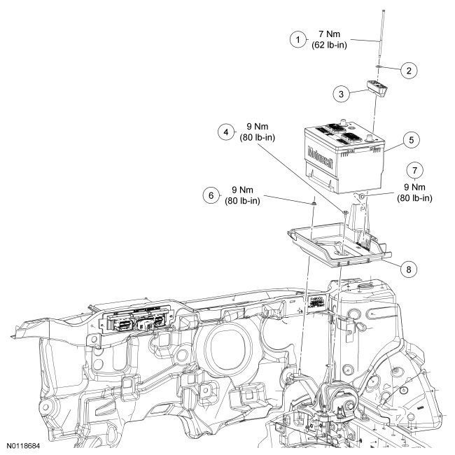

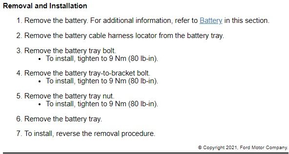

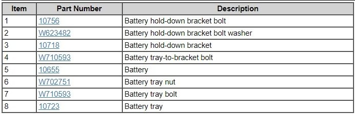

chardagha Posted June 12, 2021 Report Share Posted June 12, 2021 G’day, I am trying to remove the battery tray in my ‘13 Edge SEL 3.5L due to a broken clamp bolt. How difficult is the procedure and does anything, other than the battery, need to be removed for access? TIA Quote Link to comment Share on other sites More sharing options...
Haz Posted June 12, 2021 Report Share Posted June 12, 2021 (edited) Here you go... Good luck! Edited June 12, 2021 by Haz 1 Quote Link to comment Share on other sites More sharing options...
chardagha Posted June 12, 2021 Author Report Share Posted June 12, 2021 Thank you for the excellent response and procedure layout! Should be a snap. Quote Link to comment Share on other sites More sharing options...
