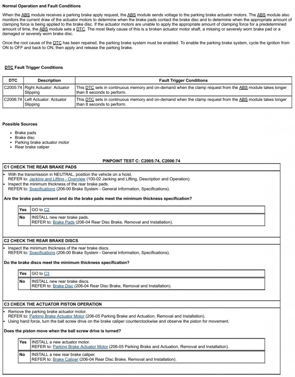

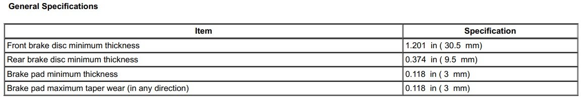

Since you didn't mention the Edge's model year, I pulled this from the 2018 Edge Workshop Manual...
