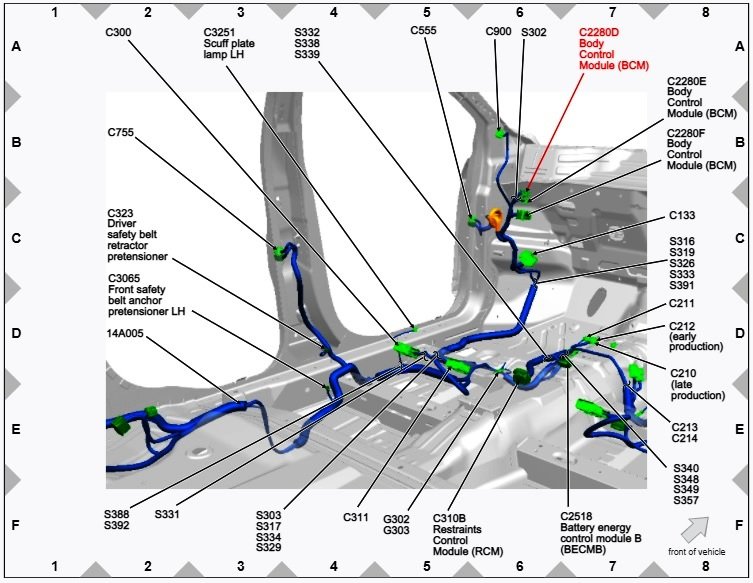

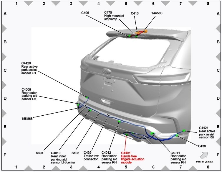

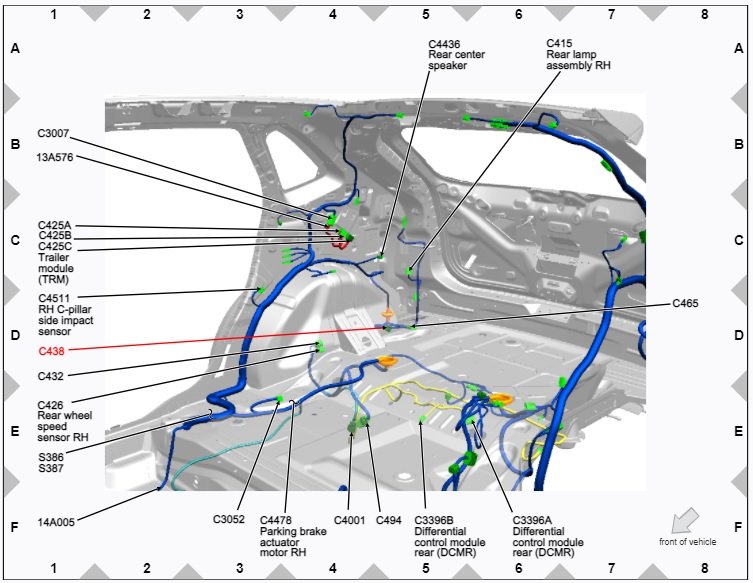

As informational references toward your researching component costs and connector/circuitry availability & requirements, the following are PDF links to related sections from the 2020 Edge Workshop Manual (since you did not mention model year) and connector/component location diagram images.
It appears the added Hands Free Liftgate Actuation module with the Upper & Lower sensors deliver an "open sesame" message to the Body Control Module, which then triggers the liftgate to open, similar to using the dash or cargo area switches.
Module programming may also be required, perhaps using Forscan, but I am not certain.
I am unsure if your local dealership can get authorization to add hands free liftgate actuation, just in case you are not a do-it-yourself owner.
It would likely be much more costly to add than the factory-installed option pricing.
Good luck!
Hands Free Liftgate Actuation Components Description and Location Diagram - 2020 Edge Workshop Manual.pdf
Hands-Free Liftgate Actuation Module Removal and Installation - 2020 Edge Workshop Manual.pdf
Hands-Free Liftgate Actuation Upper Sensor Removal and Installation - 2020 Edge Workshop Manual.pdf
Hands-Free Liftgate Actuation Lower Sensor Removal and Installation - 2020 Edge Workshop Manual.pdf
Hands Free Liftgate Wiring Diagram - 2020 Edge Workshop Manual.pdf
Connector C4401 Wiring Legend Hands Free Liftgate Actuation Module - 2020 Edge Workshop Manual.pdf
Connector C438 Wiring Legend - 2020 Edge Workshop Manual.pdf
Connector C2280D Body Control Module Wiring Legend.pdf
Hands Free Liftgate Actuation Module Connector C4401 Location - 2020 Edge Workshop Manual.jpg
Hands Free Liftgate Actuation Module Connector C438 Location 1 - 2020 Edge Workshop Manual.jpg
Hands Free Liftgate Actuation Module Connector C438 Location 2 - 2020 Edge Workshop Manual.jpg
