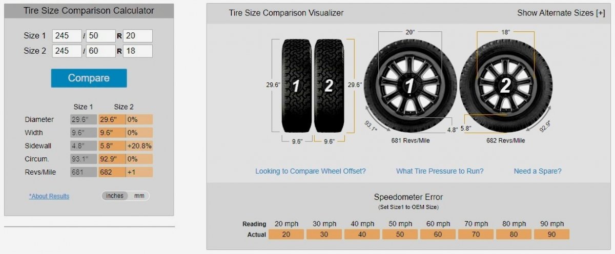

According to TireSize.com, moving from factory 245/50/R20 tires/rims to factory 245/60/R18 tires/rims will not 'mess up a number of systems'.
They are essentially equivalent in all dimensions except sidewall, with the R18 providing another inch of sidewall height, which is likely why Ford okays R18 chains, because the extra inch avoids the chains contacting the rim...
1067805891_TireSize_com-245-50-R20comparedto245-60-R18.thumb.jpg.964e28dfc85b77f63a531c0ebd95a030.jpg
In defense of the dealer rep's comments, some moves in tire/rim size do impose speedometer error which they may be restricted from correcting.
I swapped the factory R18s from our 2012 MKX with factory R22s from our new-to-us 2015 MKX, which necessitated using Forscan to alter As Built data values in the Body  Control Module (BCM) and the Antilock Braking System (ABS) Module -- not difficult to accomplish with a laptop, a short-term no-cost Forscan license, and an OBDII data port adapter.
