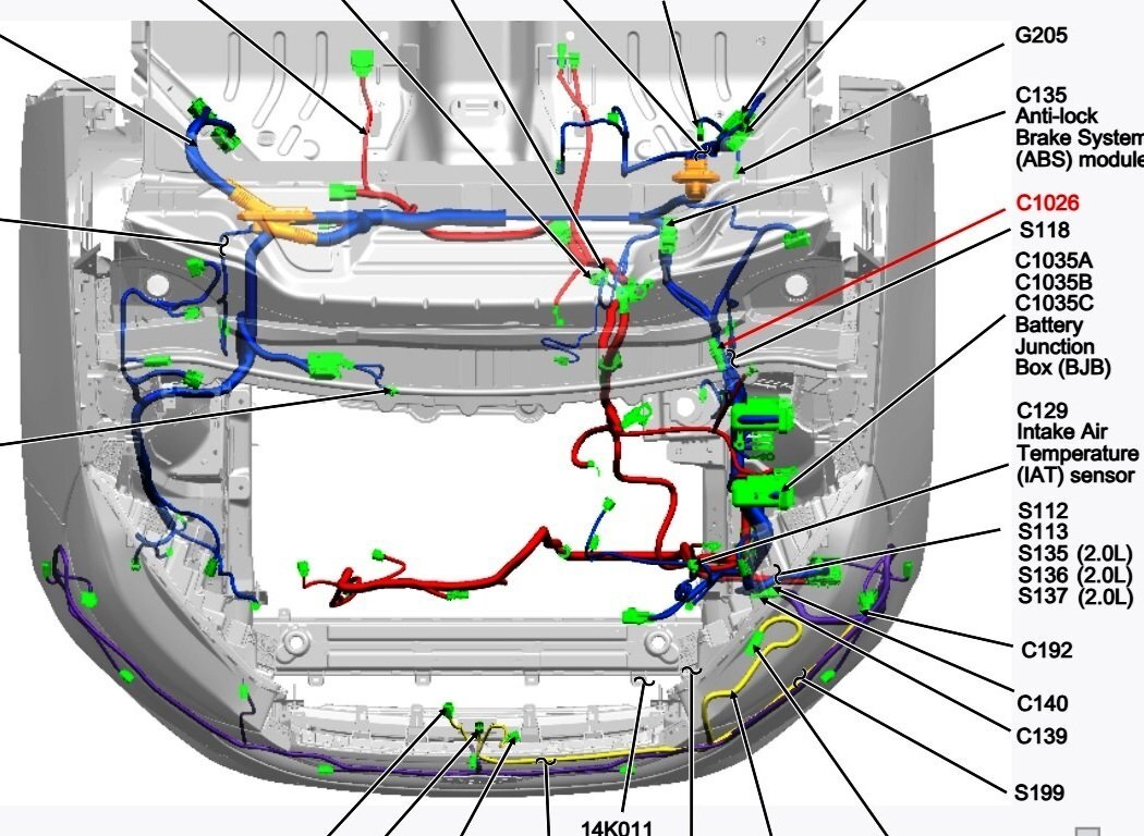

Haz Posted May 14 Report Share Posted May 14 (edited) Additional information on Inline Connector C1026 (described as "in engine compartment on left side") attached below as PDF documents... Good luck! Inline Connector C1026 - Location - 2019 Edge.pdf Inline Connector C1026 - Pinout Diagram with Fuller Circuit Description - 2019 Edge.pdf Inline Connector C1026 - Pinout Diagram - 2019 Edge.pdf Inline Connector C1026 - Location - ENHANCED IMAGE - 2019 Edge.pdf Edited May 14 by Haz 2 Quote Link to comment Share on other sites More sharing options...
