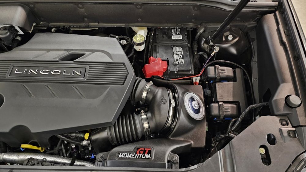

TylerAxis88 Posted October 27, 2023 Author Report Share Posted October 27, 2023 (edited) After a couple months of ordering the intake I finally got it a few days ago. Instal took maybe 25 min. Most of the time was taking off the front strut tower brace and engine cover. After that it was maybe 5 min. Fit and quality was perfect. Driving it for a few days I did notice low end throttle response is better and it pulls a tad harder on the top end from about 4K rpm- to redline. Maybe a little bit more low/mid frequencies in sound difference. Running some datalogs the intake at WOT pull in temps 2-5 degrees that of ambient outside temps. I’m happy with the install and purchase and think once I do downpipes/exhaust it will help even more. Once I get back from Florida, I’m working on my new FMIC grill and installing the grill, intercooler, turbosmart BOV, and UP rear motor mount. The suspension install isn’t until 11/27 as I’m still waiting for my Addco rear sway bar and whiteline rear end-links to get here. Hopefully in December/January I’ll get the downpipes in and I’m really sold on the AFE Vulcan 2.5” catback for the Edge ST price is about the same as I would pay for custom exhaust and I like that it is quiet and still has a decent tone to it. With the downpipes it should be a little more aggressive sounding. Edited October 28, 2023 by TylerAxis88 1 Quote Link to comment Share on other sites More sharing options...
