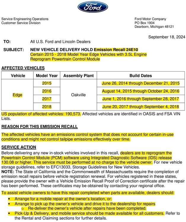

I also received the notice for our 2018 Edge. I'm very reluctant to get this done without further details. What emissions are potentially not met in real conditions? What does this reprogramming cause?
I'm all for reducing actual emissions, but I'm concerned it will just decrease MPG or decrease performance by tuning the emissions for some theoretical compliance.
It is just that Ford has done things like this in the past where they issued recalls that were 'easy for them' but not in the benefit of the owner.
(E.g. this recent one 24-2188 Ford Wheel Technical Service Bulletin where instead of replacing a vacuum line to fix the partial engagement of 4A, they just cap them which disables 2H mode and always runs in 4A.)
