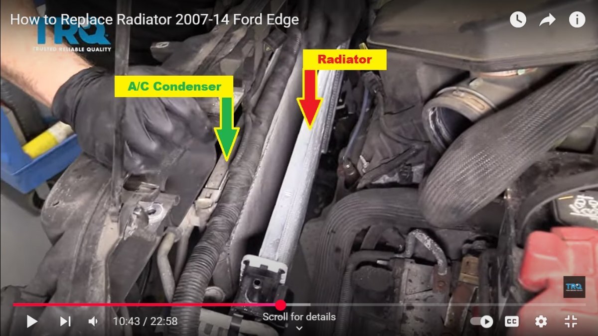

mdjbhouse Posted May 3, 2025 Report Share Posted May 3, 2025 (edited) 2013 SEL and ac stopped working. A friend said we can try and top up the freon as a start but when we tried that we noticed it started to hiss out from the front. Turns out when we heard that loud bang some time ago it looks like a rock went through the grill and damaged the rad. He said it's like a secondary rad? I found a video on changing out the main rad and I think I can see what is the rad I am interested in in front of it but he doesn't mention it (not that he should I guess). Just wondering if there in fact a secondary rad for ac and if it would be the same kind of steps involved to get to it as in the repair video to remove the main rad? https://www.youtube.com/watch?v=inpTHMy758M Edited May 4, 2025 by mdjbhouse typo Quote Link to comment Share on other sites More sharing options...
mdjbhouse Posted May 3, 2025 Author Report Share Posted May 3, 2025 (edited) ahhh, by searching for radiator on the forum I did see a post where someone hit a deer and similar situation with the suggestion of 'Yes, the ac condenser is in front of the rad and likely broken.' So I think that will help narrow down what I am looking for. Based on the video I saw I will assume it might still involve removing the rad - guess we'll see. Edited May 3, 2025 by mdjbhouse Quote Link to comment Share on other sites More sharing options...
Haz Posted May 4, 2025 Report Share Posted May 4, 2025 @mdjbhouse: The TRQ YouTube video you referenced above shows the Air Conditioning (A/C) Condenser remaining in place as the Radiator is being removed... You are correct that the radiator must be removed in order to access your Edge's damaged A/C Condenser and to install its replacement. Attached below, as PDF documents, are relevant Air Conditioning System sections from the 2013 Edge Workshop Manual, which detail the equipment and procedures required to successfully restore the operation of your Edge's A/C System. If you and your friend are inexperienced in A/C System repair, you may want to consider having a professional technician at a dealership or independent facility perform the repair on your behalf. Good luck! Air Conditioning — Exploded View - 2013 Edge Workshop Manual.pdf Condenser Core — 3.5L, 3.7L - Removal and Installation - 2013 Edge Workshop Manual.pdf Condenser Core — 2.0L EcoBoost - Removal and Installation - 2013 Edge Workshop Manual.pdf Air Conditioning - Description and Operation - 2013 Edge Workshop Manual.pdf Air Conditioning - Specifications - 2013 Edge Workshop Manual.pdf Air Conditioning (A-C) System Recovery, Evacuation and Charging - General Procedures - 2013 Edge Workshop Manual.pdf Refrigerant Oil Adding - General Procedures - 2013 Edge Workshop Manual.pdf Refrigerant System Tests - General Procedures - 2013 Edge Workshop Manual.pdf Air Conditioning (A-C) System Flushing - General Procedures - 2013 Edge Workshop Manual.pdf 1 Quote Link to comment Share on other sites More sharing options...
