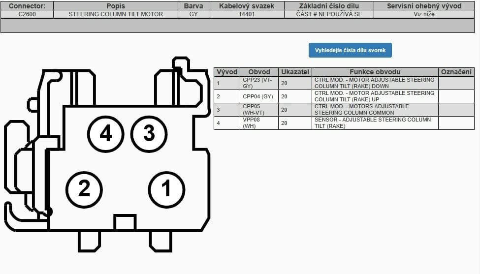

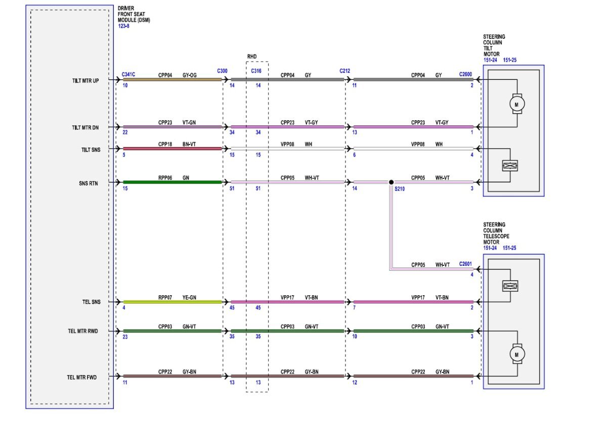

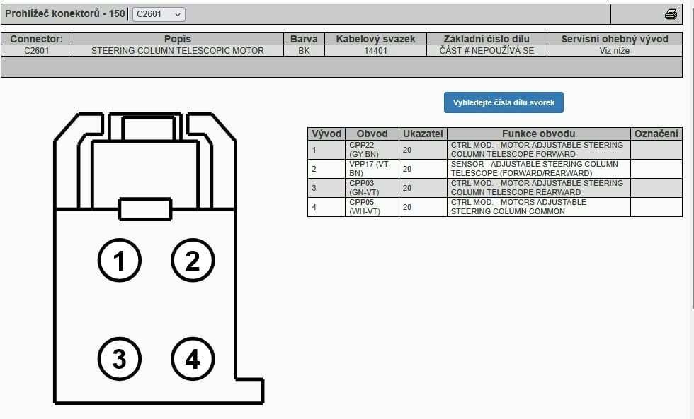

marekrbk Posted 4 hours ago Report Share Posted 4 hours ago (edited) DSM ****** need with ucds enable parameter Column Tilt capable and tele capable- Present Sccm *****Electric steering wheel Telescope + Tilt -Enabled Column coding must be started via forscan in the menu PATS Programming Edited 2 hours ago by marekrbk 1 Quote Link to comment Share on other sites More sharing options...
