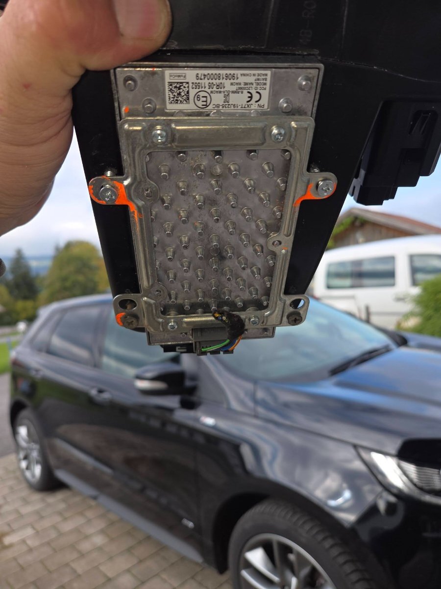

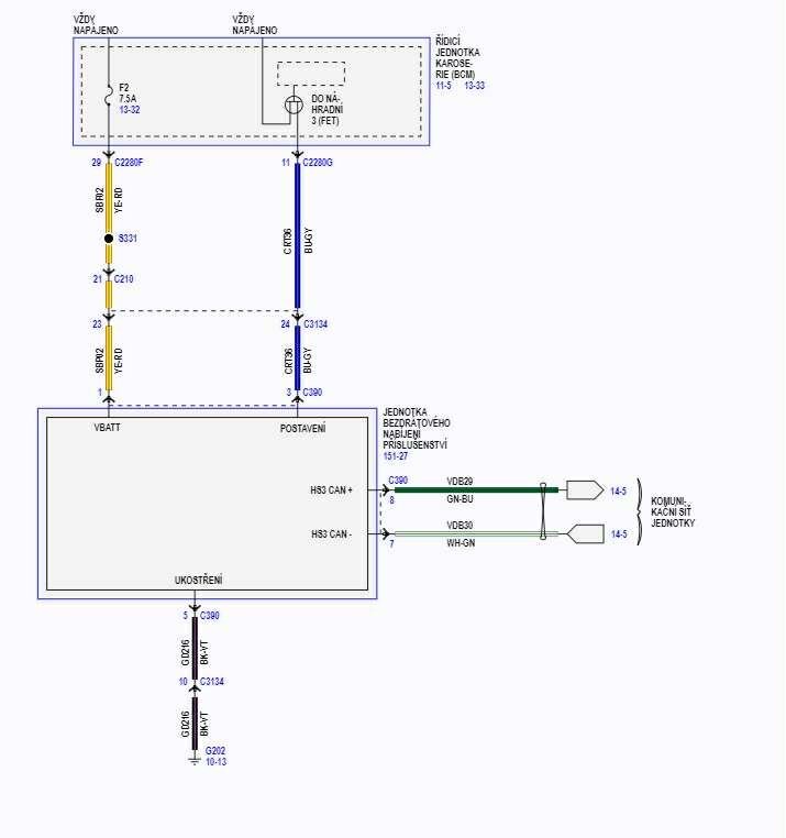

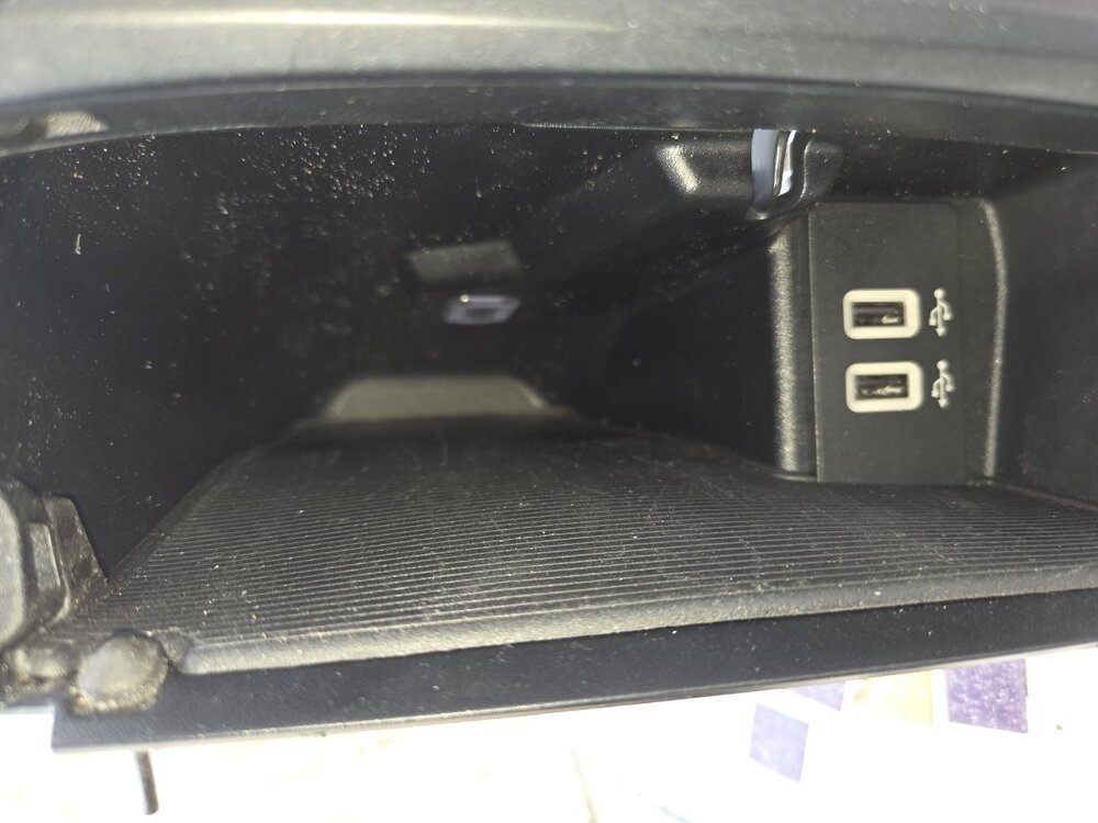

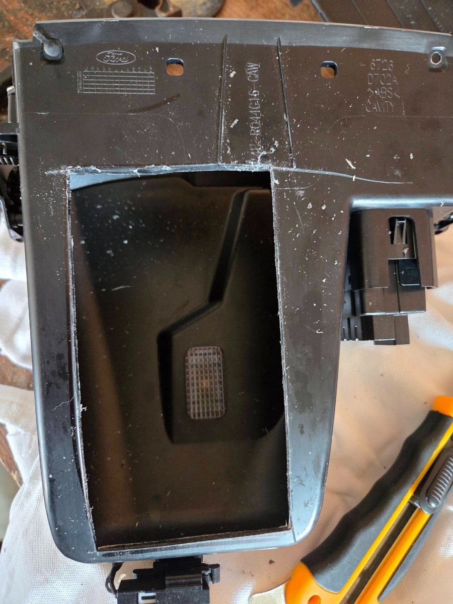

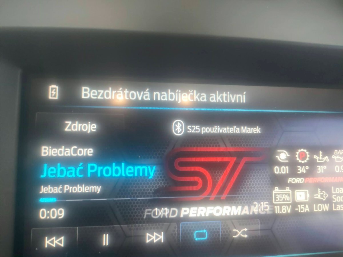

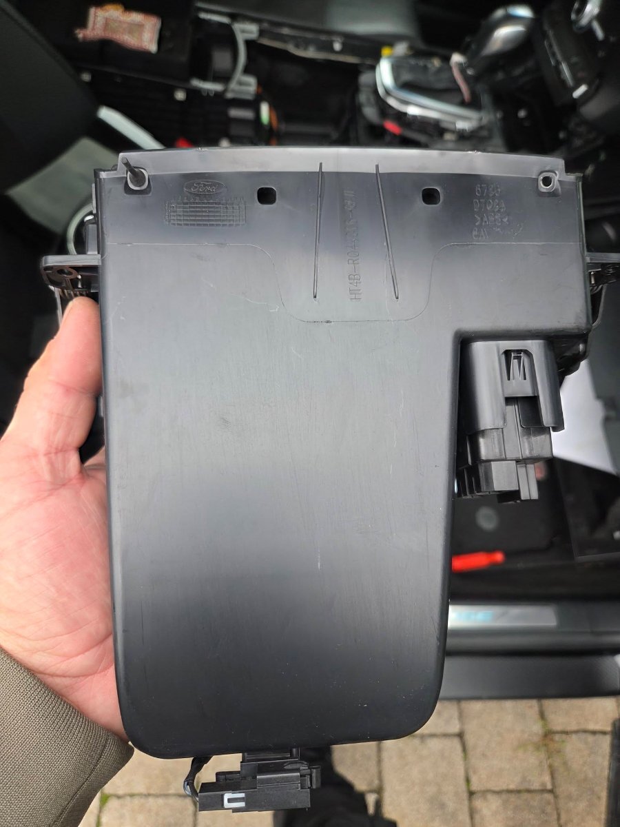

marekrbk Posted October 17 Report Share Posted October 17 (edited) WACM – wireless charger. Connects to the HS3 bus and must be activated in the APIM. The installation method is improvised. Hardware: JX7T-19J235-BC Edited October 17 by marekrbk 2 Quote Link to comment Share on other sites More sharing options...
