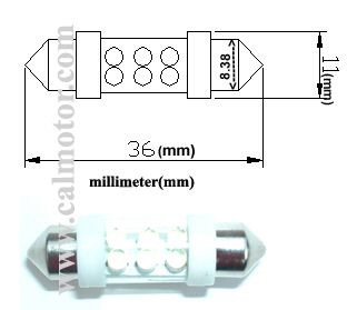

Okay.. after much research and what not, here is my plan of action to do ALL the bulbs inside the car having already done the license plate bulbs. I believe I have measured this all out correct and have the items sourced all from 1 place. he is getting back to me, but here is the goal. In measuring, I see that in the case of the festoon bulbs, the lengths do not need to be right on exact... for example, in a 38mm, a 36mm or 39mm should be just fine. they are on order and I will report back.
1 rear trunk cargo area: Super white 9-LED 39mm festoon bulb
2 front map lights: Super White T10 6-Led 194-168 wedge bulbs (exact ones I did for license plate)
3 rear dome/map lights: Super White 6-LED 36mm festoon bulb

here are some tips. As I said above, getting the exact correct bulbs was a no go, so it was a matter of measuring and getting closest you could. I had to do some minor tweaks and improvise here and there, but nothing major. In the end, I had all the bulbs in in about 15 minutes.. it is during install that I determined these tips.
TIP 1: removing the front 2 map bulbs in a :censored: really. cant pry down the white plastic trim piece fare enough to comfortably get your fingers in there to even get a grab on those slippery bulbs. that took me the most time and in the end I used a pair of forceps to get up into there and grab those bulbs. the whole time there seems a risk to breaking that piece, but I got lucky. go slow.
TIP 2: as I said above, LED bulbs seems to have a + and - pole, so if you put them in and they do not come on, turn them around.
TIP 3: on the rear cargo bulb and map/dome...from the place I ordered all my bulbs, I had to pick and choose the correct length of bulb as seen above. 1 thing I failed to take into account is that the festoon bulbs they sell taper to a point on each end, versus our festoon bulbs that are flat on each end. so, when I measured, I measured correct and all is well, until I got the bulbs and realized that because of the taper, they do not totally 100% fit perfect because the surface area lost by the taper would actually touch and have more contact if they were not tapered ends. in the end, you just have to center them such that 1 side of the internal bulb clamp makes a solid grip on the bulb end while the other side will just barely come into contact with the clamp completing the circuit and viola.. point is, a 39mm would have fit better, but in super white 6-led they had no 39mm, just 36.
TIP 4: on the rear cargo bulb and map/dome...you will need to use your fingers to squeeze the bulb holding clamps a bit tighter to hold firm. I believe stock are 11mm in diameter and what I got was 10mm, so just squeeze the clamps to hold them firm.
