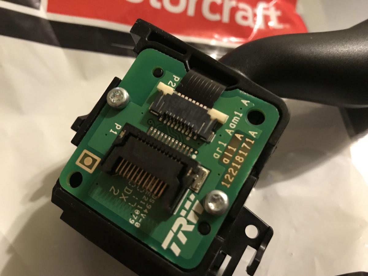

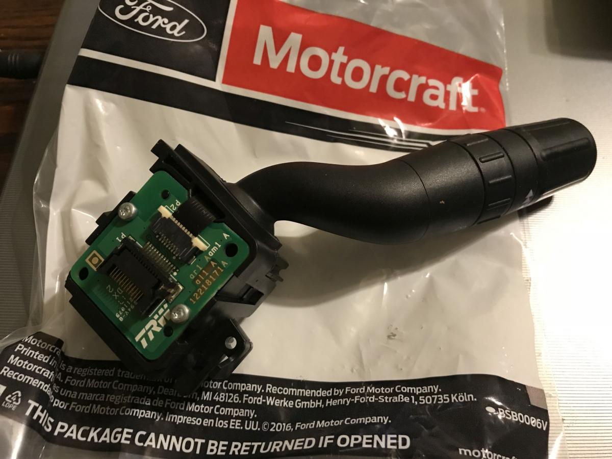

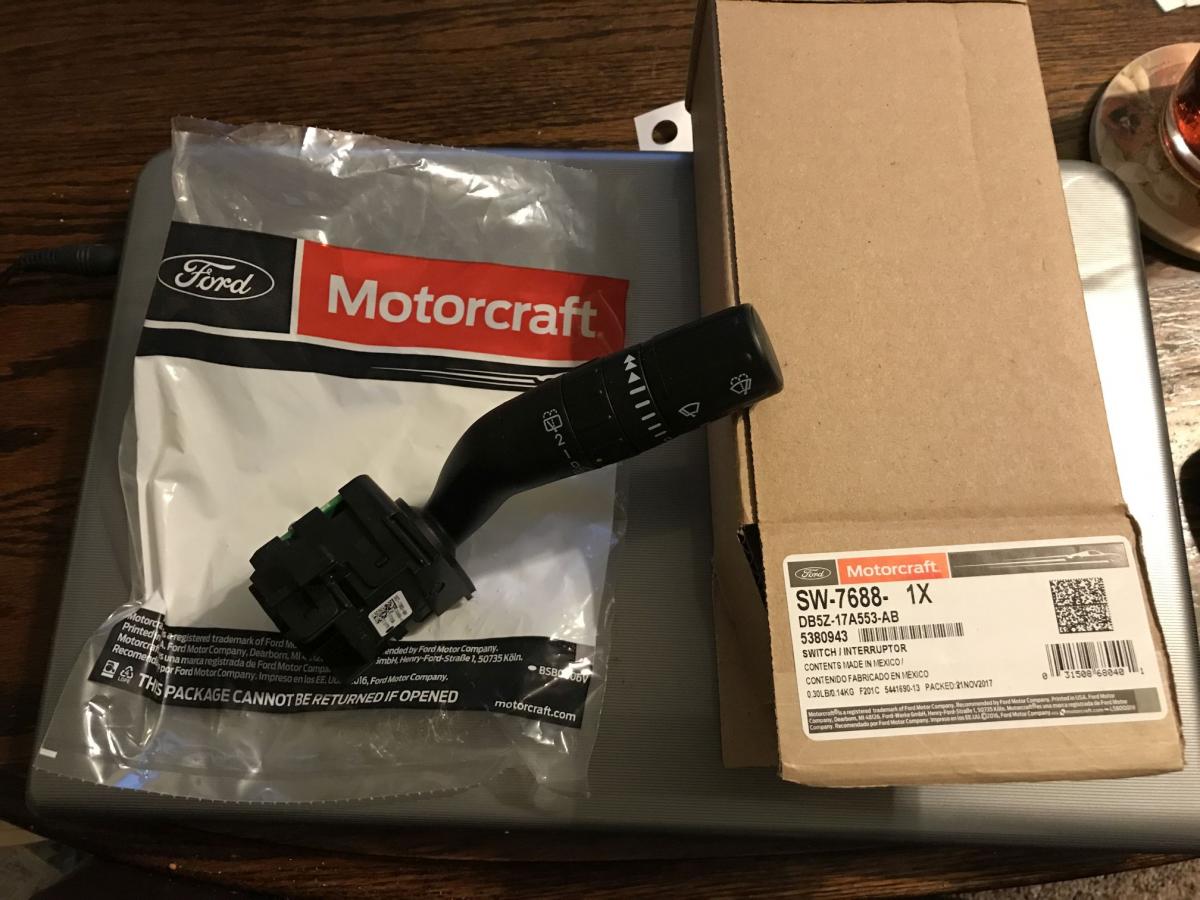

Posted 20 December 2017 - 09:23 PM
I have a 2014 Edge Limited
The wipers will turn on intermittent at random times.
I decided to try and replace the switch.
I got mine from RockAuto for $24.78 delivered.
Motorcraft SW7688  DB5Z17A553AB.
There were two different switches available.  Mine switch is the basic delay wiper.
I believe the other one was for rain sensing wipers.
I think there are different part numbers for earlier year Edge/MKXs, so look carefully.
The fact that these switches are so available, is generally a sign that Ford has had a major issue with their switches.
And leads me to believe that this is the answer to my problem.
I'll change the switch after Christmas.
I'll let you know how it goes.

So, I changed the switch yesterday.
It took about 15 minutes.
There is at least one YouTube video.
Pull the steering wheel tilt release lever down.
Swing the steering wheel up, but leave the lever down.
There are 3x 7mm screws to remove on the steering column cover.  The lever covered one of them.
Separate the upper and lower covers.  I used a plastic pry tool.
Pull the steering wheel down, and turn the steering wheel to the right a quarter turn.
Lift the upper cover up.
This should give you easy access to remove the 2x T10 torx screws holding the switch.
Then the switch may be easily slid out towards the right, or towards the passenger door.
Reverse steps for assembly.
The new switch works fine.
Time will tell if it fixes the intermittent on problem.
  • WWWPerfA_ZN0W, omar302, enigma-2 and 1 other like this
