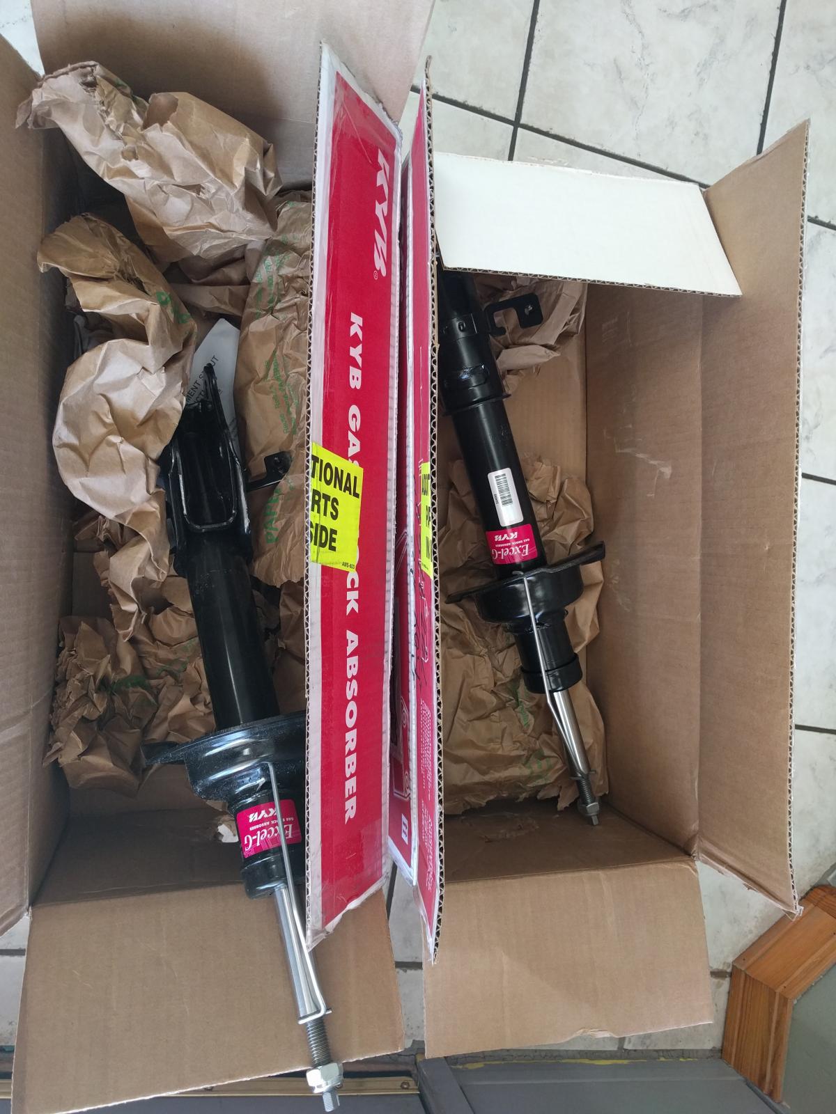

The big issues I encountered with installing my KYB struts: monroe mounting kit #907948 was a duplicate part not needed with motorcraft AD-1071. I thought they were the bottom mounts, but they are the top. I had to used the old bottoms, luckily they were in OK shape... The Moog K90461 suspension mount with bellow kit I ordered was not OEM, but neither are the KYB struts. Sort of had to guess how they went together, hopefully I got it right. Tightening the top strut rod bolt was also iffy. Instructions say not to use an impact, and while in my spring clamp with the bellow on I didn't want to try that with the old rag and vice grip/impact trick. What I did was use a 22mm deep socket (1/2" drive) with a 10mm socket and extension through it. I used vice grips on the socket and twisted the strut rod to tighten the bolt. However, I could only go so deep before the 10mm socket shoulder contacted the back of the 22mm socket. Not THAT tight, but hopefully OK. Theoretically need a special tool for this part.- 4 replies

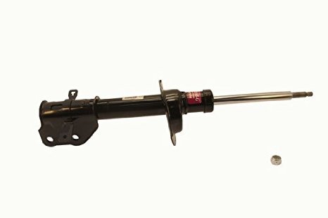

Ok, planning to do a fairly detailed suspension thread and putting together a parts list. I'd like to go OEM, but apparently there are two different part numbers based on the build date. 18" wheels. From Ford parts: Right Front AST-867 for a build date before 11/16/2008 $95.22 AST-888 for a build date after that. $90.03 Left Front AST-891 $67.44 From Rock Auto: Right Front AST913 {#AST888 $56.79 AST867 $65.79 Left Front AST910 {#AST891 $46.79 AST868 $65.79 Door Jam sticker says build date was 11/2008. Great. I have exactly 50% chance of choosing wrong. On the left I'm confident in 891, but does anyone know if there's a difference between AST913(888) and AST 867? Google says nothing... I'm almost leaning towards KYB just to avoid a frustrating return with Rock Auto. They've sold me the wrong part before, and because Ford listed the wrong part for my Taurus (bastardized fuel pump assemblies with like 20393 different build combinations) they wouldn't cover return shipping...
