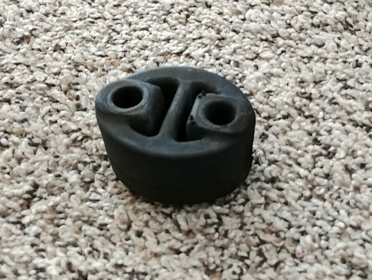

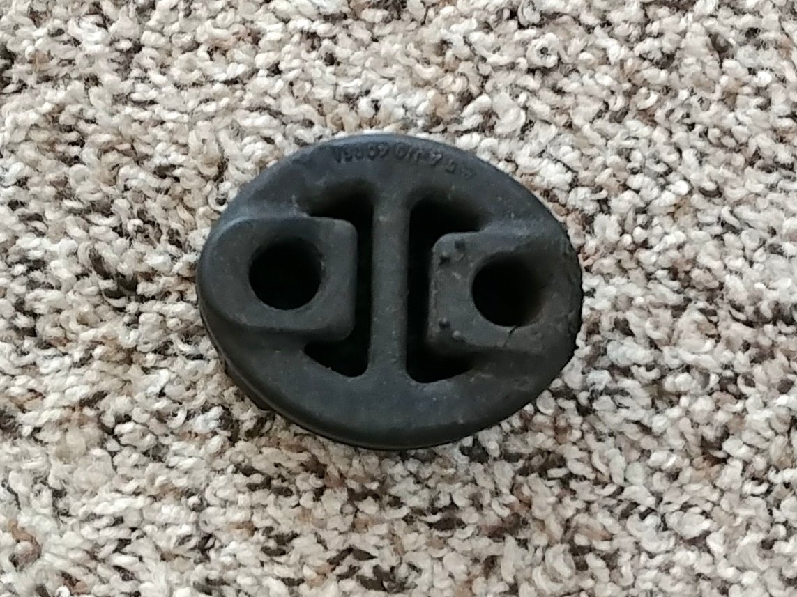

What is this part I found in my driveway?
Cyberdave replied to Cyberdave's topic in Brakes, Chassis & Suspension

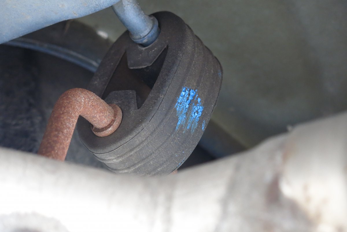

This is turning into a really weird story if you want to know. Once I knew what it was (and after looking at a video online), I looked under the car and saw each exhaust had one. I couldn't see the one behind the exhaust but I saw the one in the front. As you can see from this photo it looks different, it's not the same one. I looked under my other car and nope not that one either. The road in front of my house is a busy one and it's bumpy but people don't often realize that. My theory is that someone going too fast over the bump lost theirs and it bounced into my driveway! -
I did some googling and it looks like probably the answer is NO! -
Ok thanks! Do you think it is OK to drive the car until I can get it put back on? -
2013 Edge AWD Since it fell out onto the driveway I assume it probably came from the Brakes, Chassis or Suspension? Or maybe something related? Should I be concerned? Thanks for any info!
