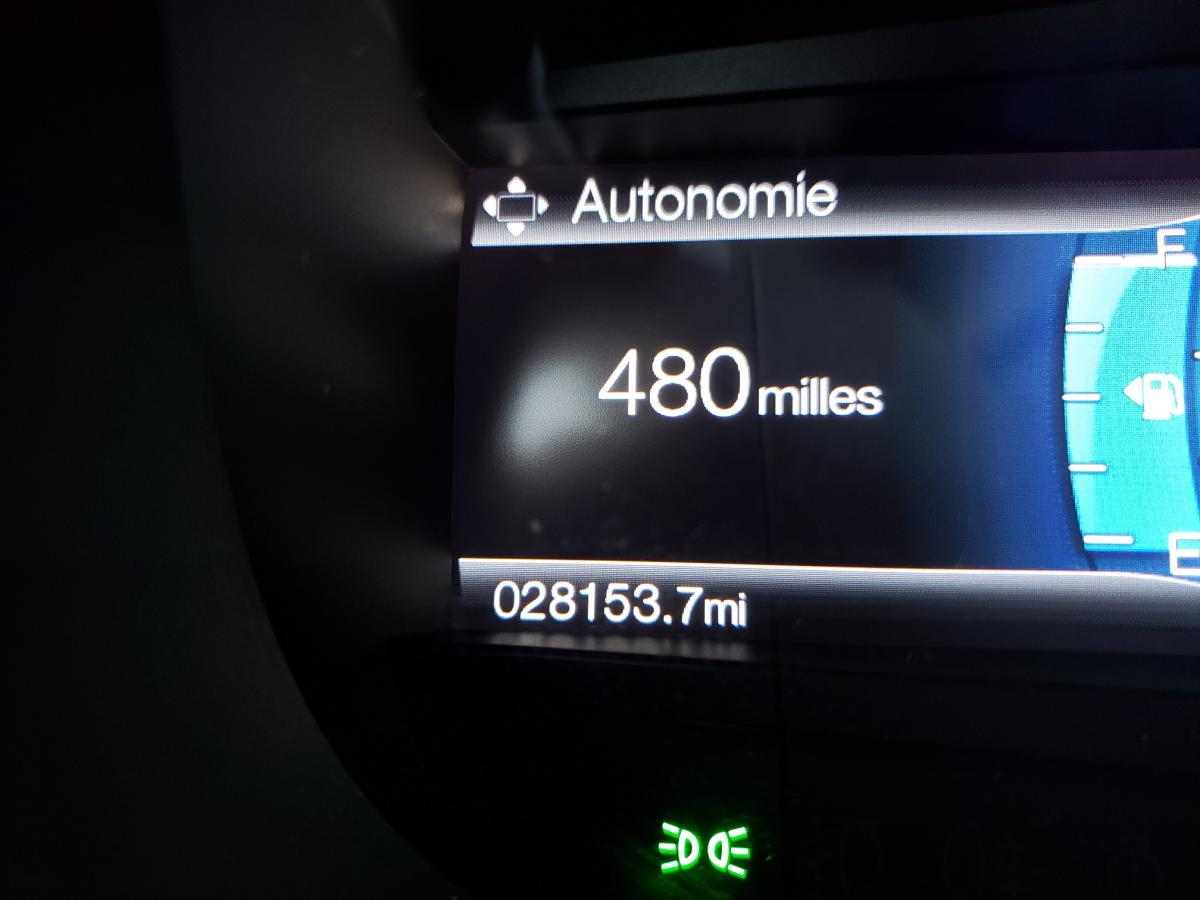

I would have to guess between 330 and 350! It's just that my MPG never been this good... a couple of months ago, I could barely drive 360 miles on a full tank, full to dead empty. I'm just surprised that 2.7EB is getting less and less thirsty!
Hi guys, Did a 6 hours drive this weekend in extreme heat with AC running almost maxed out, cruising between 110 and 120 kph (67 to 73 mph). Started with a bit more than 3/4 full tank. Arrived at destination, empty light still not on, fueled up, and had this pleasant surprise. My '16 Edge Sport tuned by LMS (91 Perf v3) is guzzling less and less gas every trip I do. Take a look at the pictures... is it just mine that is doing good MPG, or it's the case for everyone as the vehicule is getting more milleage?
