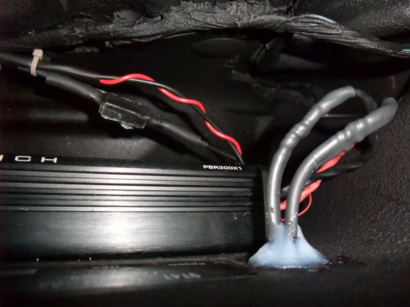

    Thanks! The only thing I did to the sub box was to enlarge the subwoofer hole diameter. I was going to use an electric scroll saw but its trigger malfunctioned. It's very old lol. So instead I used a router and simply followed the trace I had marked. I think it works better than a saw - like buttuh. I used a ½" thick custom made PVC spacer ring to mount the sub on. I did that so I would not need to butcher the sub box by the mounting tab. Instead I trimmed the spacer ring, with a file and sander, so that it fit over the top of the protrusion of the tab. I didn't want to destroy the sealed integrity of the box by cutting into that tab area. (See photo in my previous post.) Yes, I used about 6 Oz of nylon fiberfill I had on hand from a previous speaker project. I also sprayed the entire exterior of the sub box with 3M rubberized undercoating/soundproofing spray as well as the body of the Edge immediately behind the sub box as you can see in the photos posted earlier. Well, I previously posted my depth measurement at 5" from the face of the sub box. However, the box is irregularly tapered in the back so it may be less depending on the sub you intend to place in there. The sub I mounted in the box, and pictured in my previous post, is the CDT HD-1000CF http://cdtaudio.com/sep_components/subwoofers/hd1000cf.htm Spec sheet http://cdtaudio.com/pdf/HD-1000CF.pdf

    Completed: Other than the 10" subwoofer and sub amp the audio system is stock:

    UPDATE: Upgrading subwoofer on a Premium Sound System II in my 2010 Edge Limited. I ended up purchasing a Rockford-Fosgate PBR300X1 subwoofer amp for more power: http://www.rockfordfosgate.com/products/details/pbr300x1 It is small and will easily screw into the same location as where the OE sub amp was on the rear of the OE sub box. Needed a Radio Shack reed relay, part# 275-0232: https://www.radioshack.com/products/spst1a-5vreed-rly?variant=5717505029 You will need this relay to convert the OE head unit's 6Vdc sub amp enable signal to 12Vdc for aftermarket amps. See below wiring diagram or click> http://www.ford-trucks.com/forums/1159436-factory-subwoofer-upgrade-7.html#post13251877 Using very affordable custom ½" spacer rings made by http://www.car-speaker-adapters.com (Send them an email with your specs.) I will enlarge the OE sub box hole and trim a small part of the custom spacer ring to allow it to fit the encroached sub box mounting tab. In the enlarged hole I will mount a 10" CDT HD-1000CF subwoofer: http://cdtaudio.com/sep_components/subwoofers/hd1000cf.htm After the sub box cutout enlargement is completed it's a simple matter to mount everything, tie a bow on it, and enjoy some real low end. ______________________________________________________ OE Subwoofer Wiring Harness Info: Pin 1 [Violet/Red] Sub Amp Enable +6Vdc (hot when your audio head unit is turned on. ) Pin 2 [black/Yellow] Ground ⏚ Pin 5 [brown/Red] Power +12Vdc (hot when ignition key is in accessory position.) Pin 7 [Violet/Green] Sub Signal + (low level audio) Pin 8 [Green/White] Sub Signal - (low level audio) ______________________________________________________ Sub Enable Reed Relay Wiring Diagram:
