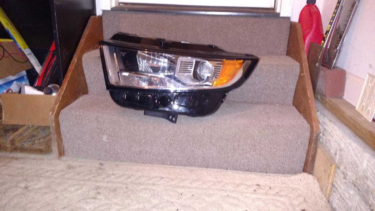

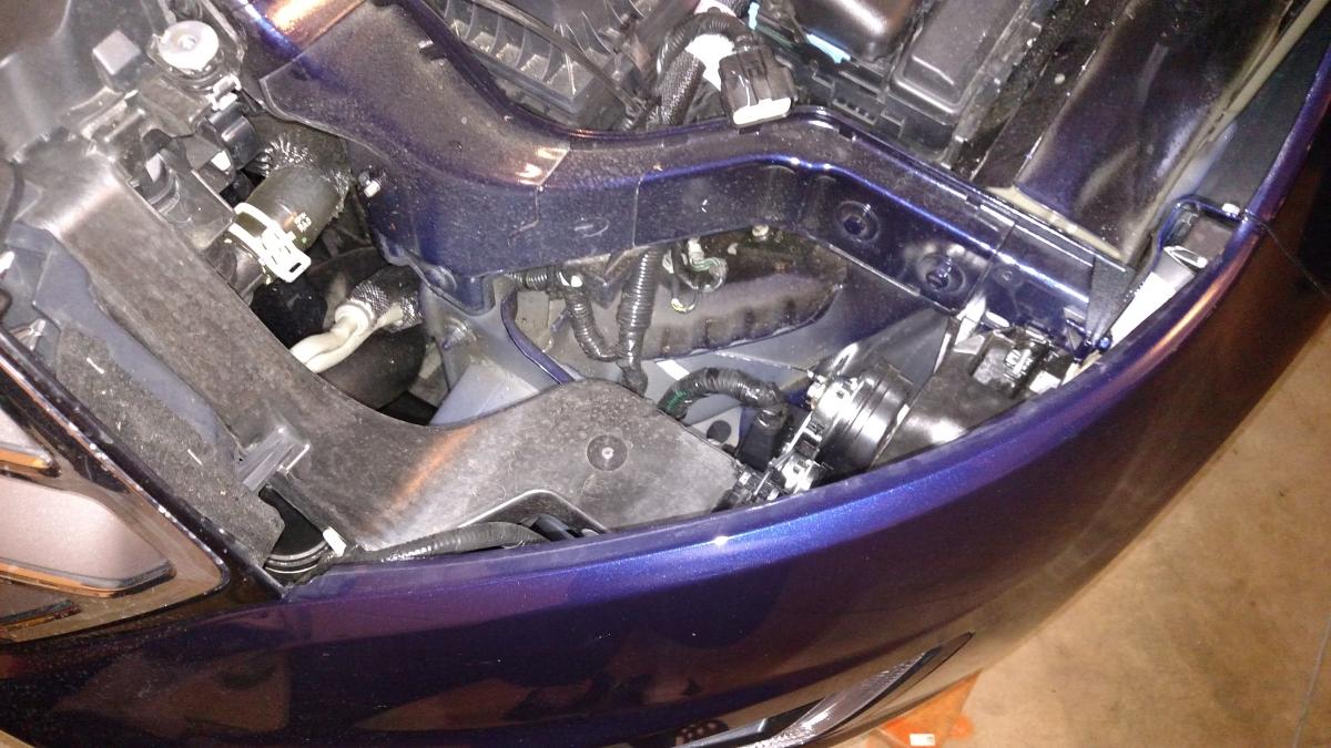

jmr061 Posted August 14, 2016 Report Share Posted August 14, 2016 (edited) The owner's manual says to remove the three screws/bolts that hold the headlamp assembly in, then pull forward to disengage and then up to remove the entire headlamp assembly. The service manual says to remove the bumper cover then remove the headlamp assembly. Anyone have luck with what the owner's manual says? I didn't want to pull forward on the assembly that hard. Don't want to remove the bumper cover. Thanks Edited August 14, 2016 by jmr061 Quote Link to comment Share on other sites More sharing options...

Beezz Posted August 15, 2016 Report Share Posted August 15, 2016 You can remove the headlights without having to take off the bumper. Already have taken mine out to clean & to spray an undercoating around parts. One of the easiest headlight removals I've ever done. Should take you less than 5 minutes total for both sides How hard did you pull on them? I can't get the lower latching point to disconnect however hard I pull. Quote Link to comment Share on other sites More sharing options...

lildisco Posted August 15, 2016 Report Share Posted August 15, 2016 (edited) How hard did you pull on them? I can't get the lower latching point to disconnect however hard I pull. I gave it a good solid jerk. Looks like it's held in with a clamp/wedge thingy (technical term) that's on the cross member. There's 2 10mm bolts & 1 plastic retainer/screw Edited August 15, 2016 by lildisco 3 Quote Link to comment Share on other sites More sharing options...
jmr061 Posted August 15, 2016 Author Report Share Posted August 15, 2016 I gave it a good solid jerk. Looks like it's held in with a clamp/wedge thingy (technical term) that's on the cross member. There's 2 10mm bolts & 1 plastic retainer/screw Any chance of editing the pics and circling the area on the "frame" and the headlamp itself where you are talking that it clips? Thanks Quote Link to comment Share on other sites More sharing options...
lildisco Posted August 15, 2016 Report Share Posted August 15, 2016 Not at this time no, but if you look at the bottom of the headlight, you'll see a plastic piece hanging down from the bottom. That's what the wedge grabs or what the headlight sits in Quote Link to comment Share on other sites More sharing options...

jmr061 Posted August 15, 2016 Author Report Share Posted August 15, 2016 There is no need to pull the assembly forward as the instructions say. Just start at the rear corner and start pulling up. Pops right out then. 1 Quote Link to comment Share on other sites More sharing options...

Beezz Posted August 24, 2016 Report Share Posted August 24, 2016 (edited) HOW THE HECK DO YOU GET THEM BACK IN????? I've been trying for 20 minutes to get the housing to lock back in. Someone spare me the misery. Update: got them back in, such a strange process / angle Edited August 24, 2016 by Beezz Quote Link to comment Share on other sites More sharing options...
