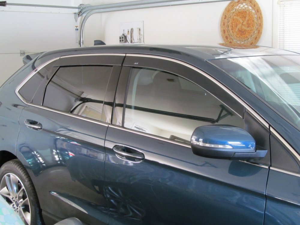

Chipster Posted September 16, 2016 Report Share Posted September 16, 2016 (edited) I used the tape on and it was fine. Here is the rub though; No matter which type you use if the reason that you want them is to lower the windows in the summer and not worry about rain... The back window's shape are such that the shade does not offer any protection for the back portion of the back windows. Nothing we can do about that...Just a FYI. Not a very good picture, but you get the idea... Edited September 16, 2016 by Chipster Quote Link to comment Share on other sites More sharing options...
Tjm623 Posted September 16, 2016 Report Share Posted September 16, 2016 They look good, sucks about back windows not working right. I don't think I'll get them for my cars again though. Loved them when I smoked for rainy days. Ever since I quit I don't typically vent the car when parked anymore or drive with them open unless it's nice out. I use global open when going to car to vent or just remote start it Quote Link to comment Share on other sites More sharing options...

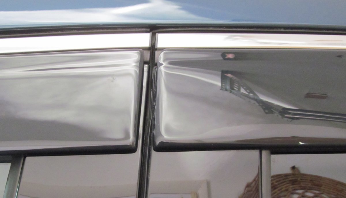

Chipster Posted December 11, 2018 Report Share Posted December 11, 2018 AVS on my 2016 as I posted before. I will warn you that if you go with the AVS to make sure that you leave a bit of clearance between the edge of the ventshade and the edge of the the door. (in my case drivers front door) It seems that after parking in the direct summer sun that the plastic grows length wise creating a bit of an issue. I had to shave the ventshade on the back door a tad (tech. term) to keep it from catching the drivers door edge. As seen in the close up image. The second image is a better look at the completed installation. Quote Link to comment Share on other sites More sharing options...
