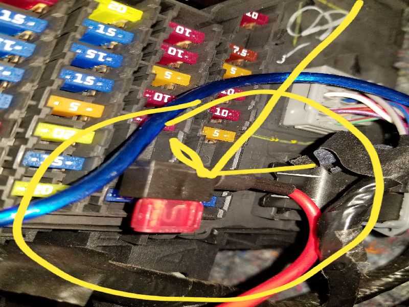

Rizsin23 Posted April 8, 2018 Report Share Posted April 8, 2018 (edited) Morning All! Wanted to show where you can tap a fuse for ignition on/off. I have my DRL strips tapped into this unused fuse location. #38 in the photo. DRL's come on when the car is started, go off when key is removed. 2014 Ford Edge SEL Since it is an unused (spare) fuse, I put a 10 fuse in the top portion of the tap only. Everything works perfectly. Let me know if you want more pics Edited April 9, 2018 by Rizsin23 2 Quote Link to comment Share on other sites More sharing options...
enigma-2 Posted April 8, 2018 Report Share Posted April 8, 2018 Excellent write up. Like to add that there is an easier way to power a radar detector or dash cam, that being to use a Mirror Tap harness and plug it into the rearview mirror connector. Powers on with the car, off (with delay) when car off and door opens. Takes only a few minutes and easy to install. Here's an example of one style: https://www.amazon.com/dp/B01LW7MGSY/ref=cm_sw_r_cp_apa_NgMYAbADGZ8G2 ($40 but you can buy China brand for less yhan $20). 2 Quote Link to comment Share on other sites More sharing options...
Rizsin23 Posted April 9, 2018 Report Share Posted April 9, 2018 Agreed on the mirror tap, however I didn't want the delay with the lights, hence going straight to the source No delay! 1 Quote Link to comment Share on other sites More sharing options...
