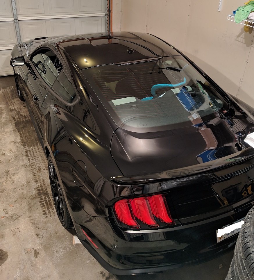

I hear you about the false advertising. I genuinely think it was the Megs marketing department that tried to leverage the current "IN" thing in detailing to push the product. I frankly dont care what its called, I applied the second coat to my Mustang yesterday and I am genuinely impressed (will upload a pic in the next post)!
Back in the day, I use to do my family's cars just for the love of it. Thought about doing something on weekends but I am too lazy LOL!
Clay, 1 Pass Megs UC just to brighten the surface (cant afford to remove too much clear when you live in Albera - you will run out before you sell the car LOL!), 2 coats of Megs HC. The paint is not perfect but the gloss is amazing and it beats like a mofo. Will give Fusso Soft99 a good run for its money.
So far I've done the hood, front fenders an bumper and the rear hatch and bumper.  I found that the UC can be skipped and it works out OK. There's a noticeable difference in the parts I've done. Not perfect, but very good. Plus the satisfaction that comes from doing it myself. Going forward the MKX will either be hand washed or spray washed, so as I own it it will only get slowly better then it is now.
