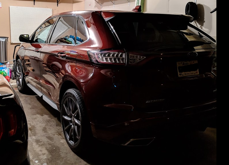

Pic below is of my Edge after the winter, had some serious swirls, process was: wash, clay, 1 Pass Megs UC with a medium cutting/polish pad, 1 coat of Megs Hybrid Ceramic. The paint isnt 100% perfect but as a daily driver that is 4 years old, the purpose was to clean-up the clear coat and then seal. This is my daily, not a showcar so I value layers of clearcoat over a 100% perfect finish (i reckon finish is about 85% corrected)
Edit: Picture below
