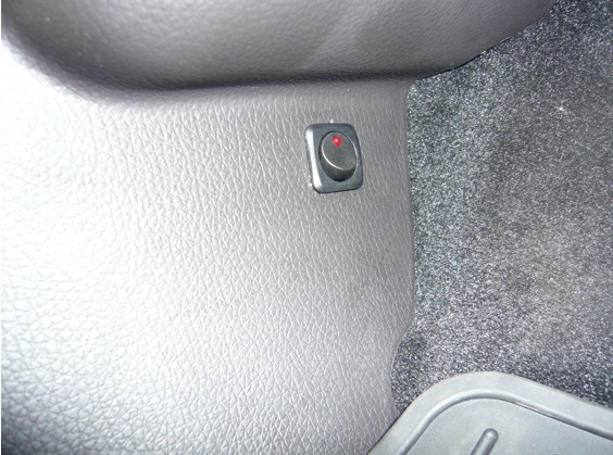

no worries just teasing.. you might consider a smaller more flush mounted rocker switch versus that toggle. seems with the rocker, like one I used below for another application.. it would at least allow the use of that cubby hole still.. seems you kind of loose that due to the toggle switch sticking out into it.
Whats the toggle for anyways????
I have the Ohio Revised Code on DVD and would like to review it while I am driving (you can never know too many laws), this switch allows me to watch a dvd, for educational purposes only on my 14 hour trip to the house of mouse coming up soon, while I am driving. :yup:
This switch also helps in performing Bluetooth operations while the car is in motion. Of course for emergency phone calls only, i.e. police, pizza, mother-in-law!
I like the rocker switch better Lex. When I clean up the Ipod hole I might just switch that out. The one I used was the finest Wal-mart had to offer at the time.
