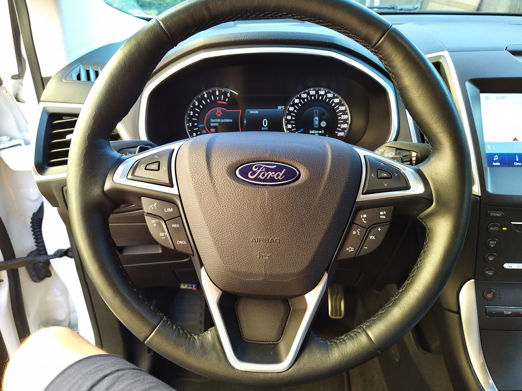

Thank you for your reply. I already removed the steering column bottom cover, but can't see how to go on now. Better if I post some pictures:
This is the wheel type I'm referring to:

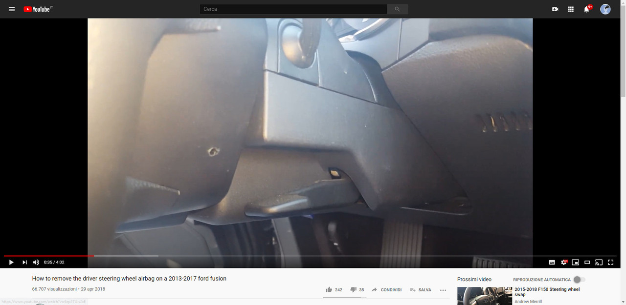

I found a youtube video explaining how to remove the Fusion steering wheel, that is identical (but without the plastic 'square' at the bottom of the wheel)
It refers to this hole that should be found on the bottom:

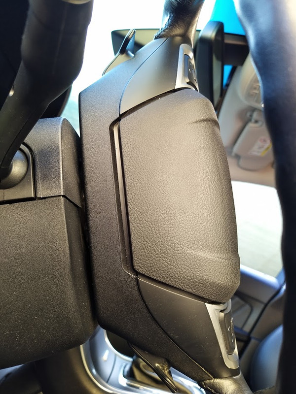

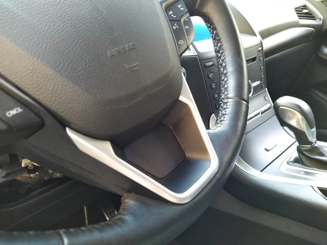

unfortunately my wheel is different there:
That black plastic seems to not be a cover but the actual wheel, i.e. not removable.

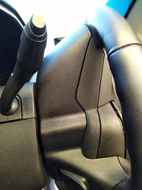

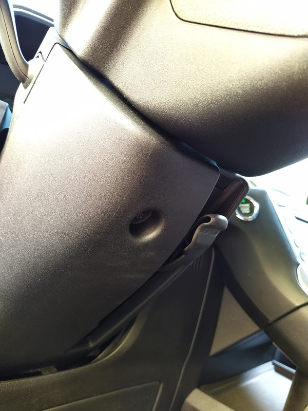

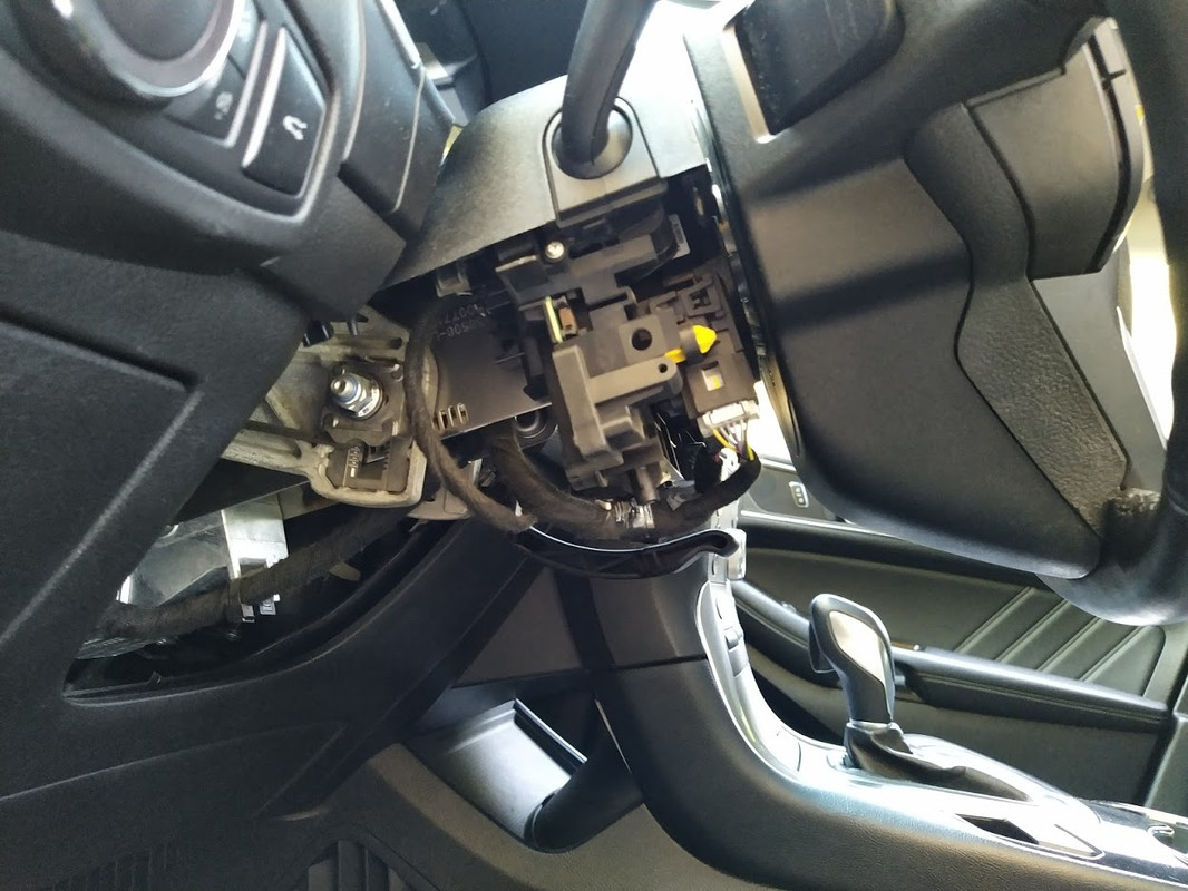

So I removed the steering column cover
It seems that european Edge have only one screw there..

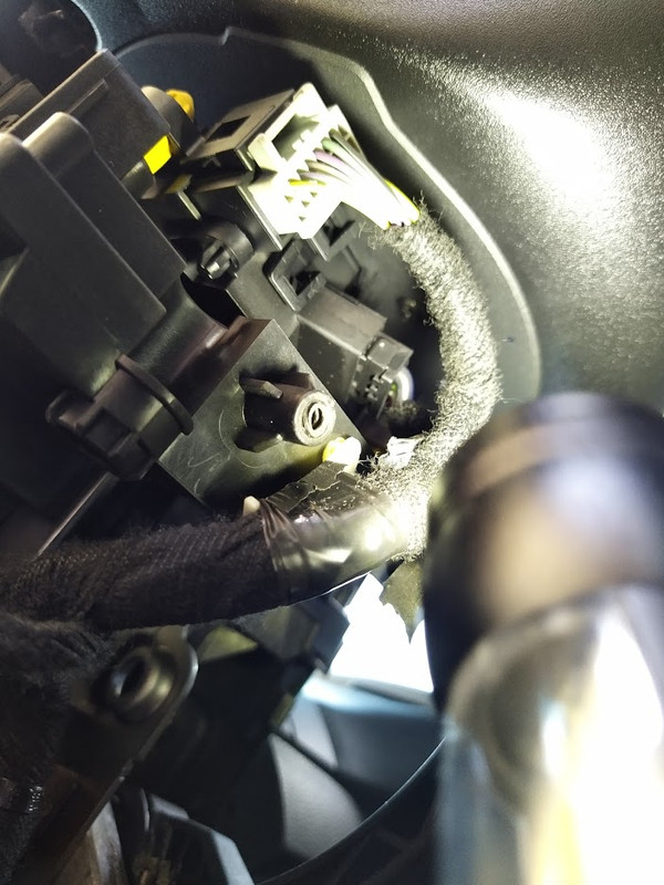

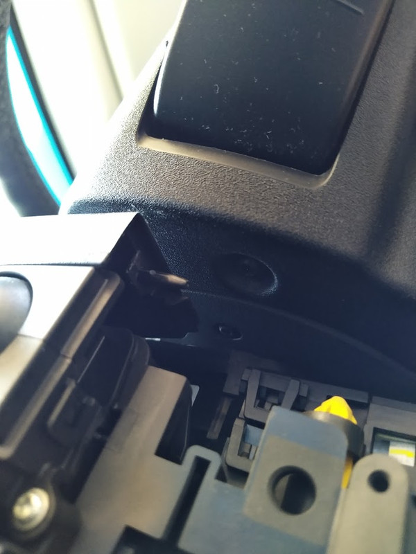

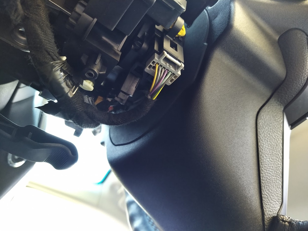

but even without the cover, I can't see anything useful:
a small screw is vibile here, but not reachable
another couple of screws, but not useful
(I found another video that has the steering wheel already out, with these screws still installed)

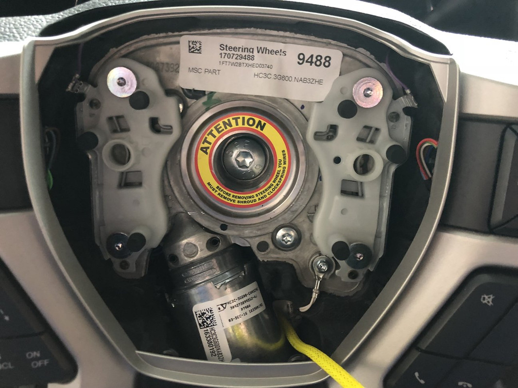

The last picture shows the screw i was talking about.  If that comes out then that back plastic piece on the steering wheel should come off.  Then you should possibly see the release for the airbag.  Also the only way to get the steering wheel off is the bolt behind the airbag
You need to also remove the top steering column cover to expose the other torx screw. See the attache procedures. You don't need to remove the Airbag.
For information, the 2016-2018 Edge Sport has an adaptive steering, so removing the Airbag is slightly different. The holes for removing the Airbag (same location) are covered. You would need to make slits to the steering wheel trim at the same location where they would be. You would know if it was removed or not earlier. I know this because my 2016 Sport first had the driver Airbag recall (replacement), so the dealer had to make the slits. Then I had the Adaptive Steering wheel recall (also replaced). So now the slits are gone. Good as new.

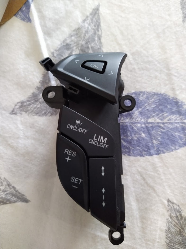

However the switch assembly I need to replace is the one on the steering wheel, not the one behind it:
so I need to remove the airbag to access the inside of the wheel.

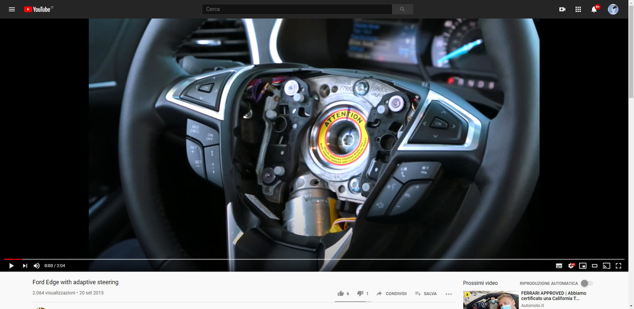

EDIT: just found a youtube video about adaptive steering, showing the inside of the wheel:
It seems that the lower 'hook' is missing (due to the a.s. motor) ant that there are two hooks on each side. You probably need to make the slits only there.
A better look here, from a '17 f250
img-8823-1-4644df79bc998d05214ba7c783413
the two big 'holes' on the side seems the place to insert something from the back and push the metal clips.
