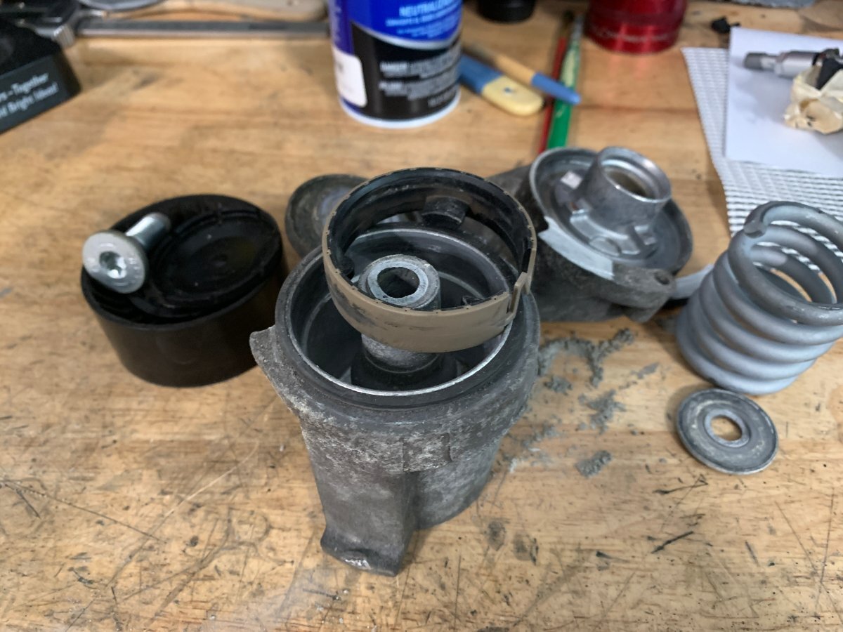

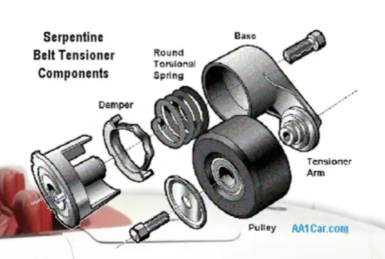

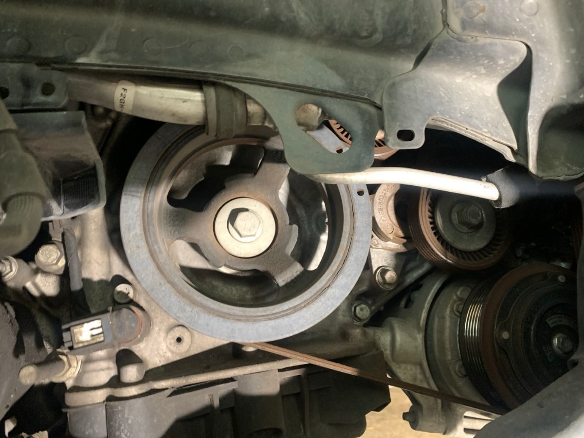

1004ron Posted April 10, 2024 Report Share Posted April 10, 2024 In the case of my wife's BMW it was the tensioner doing a jiggle that drew my attention to the need to replace these components, and the reports that when the belt goes on the BMW engine it typically trashes the crank main seal. The failure mode that leads to the tensioner oscillation is a worn or contaminated (oil) friction damper - not a worn spring as many suggest. A previous vehicle of mine used a flat friction disc whereas the BMW use a friction drum - you can see in the attached photo of the old tensioner that I tore apart. The tensioner's bearing felt and sounds rough while the idler felt and sounded smooth. 1 Quote Link to comment Share on other sites More sharing options...

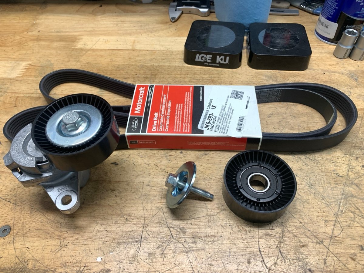

1004ron Posted April 10, 2024 Report Share Posted April 10, 2024 Thanks @omar302 I decided to go with Motorcraft seeing as the existing components have been trouble free for so many years and miles, although I also have a lot of confidence in Gates. The tensioner in that example uses an external hydraulic damper which I believe will extend the life of the tensioner assembly compared to ours with an internal friction type damper. 1 Quote Link to comment Share on other sites More sharing options...
Cerberus Posted April 10, 2024 Report Share Posted April 10, 2024 2 hours ago, 1004ron said: The tensioner's bearing felt and sounds rough while the idler felt and sounded smooth. This is the most common reason to replace tensioner or idler, bearing noise or crunching Quote Link to comment Share on other sites More sharing options...

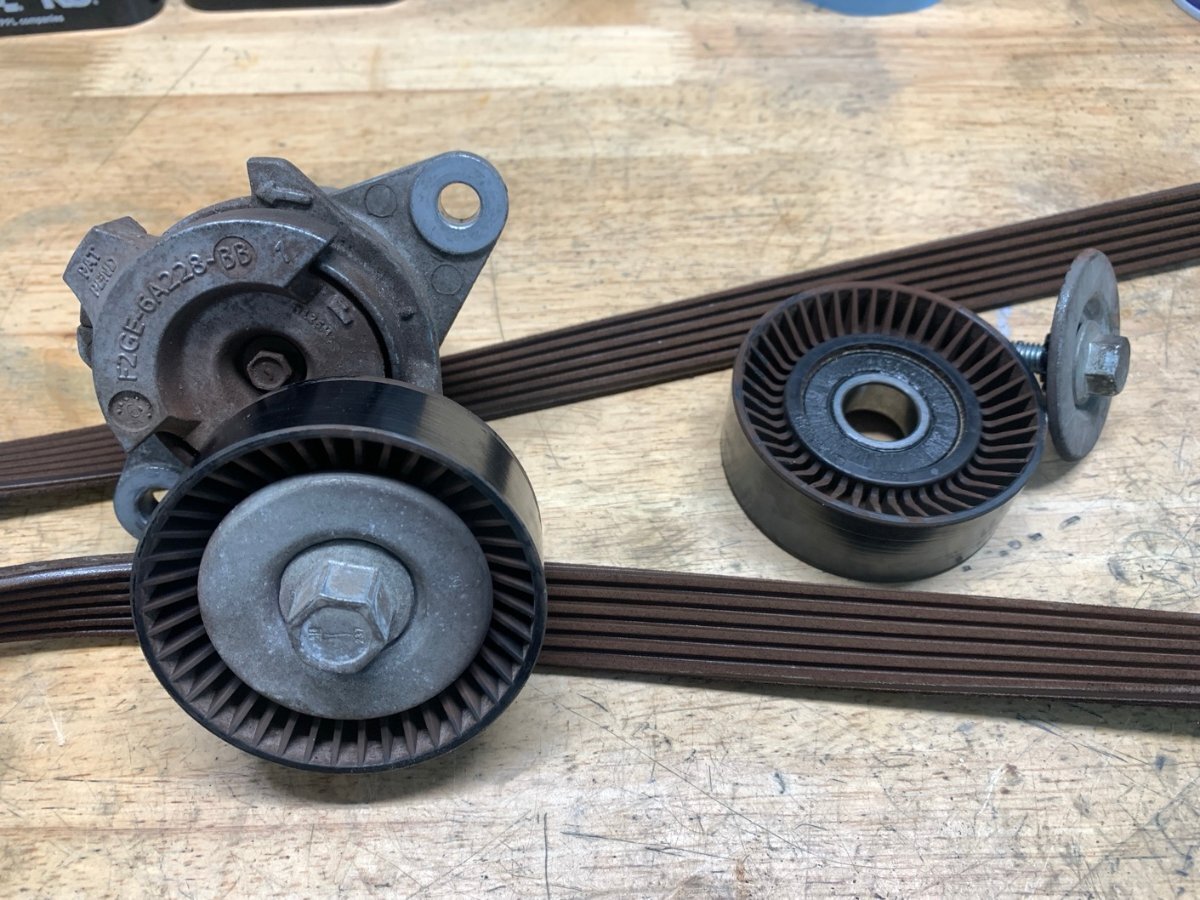

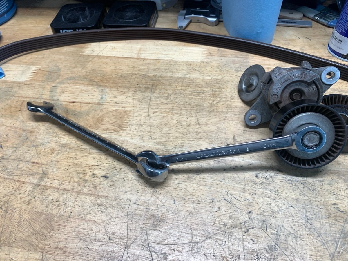

1004ron Posted April 13, 2024 Report Share Posted April 13, 2024 Took about 1.5 hours to complete this morning. All the old parts were in really good condition and the only real sign of deterioration was the idler bearing, it had expelled a little lubricant and felt just a little notchy. There's no room to get a socket and breaker bar on the tensioner to retract it for removal and installation of the belt so resorted to two ratchet wrenches seen in one of the photos. No doubt these components were good for another few thousand miles but I cant put a number to it, so given the choice again I'd change them at the same mileage, 103,000 mi. 3 Quote Link to comment Share on other sites More sharing options...
