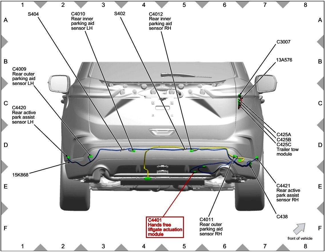

Is there a way to remove or turn off the lift gate sensor? I have a 2022 Ford Edge.  I still want to be able to use the key fob and the button by the steering wheel.  I just don’t want to be able to use the the lift gate with the sensor by kicking my foot underneath.  It has come down on me to many times and hit me in the head.
The 2022 Edge Owner's Manual, on page 83, describes deactivating the Power Liftgate raise-lower function, but makes no mention of deactivating the Hands-Free Sensors...

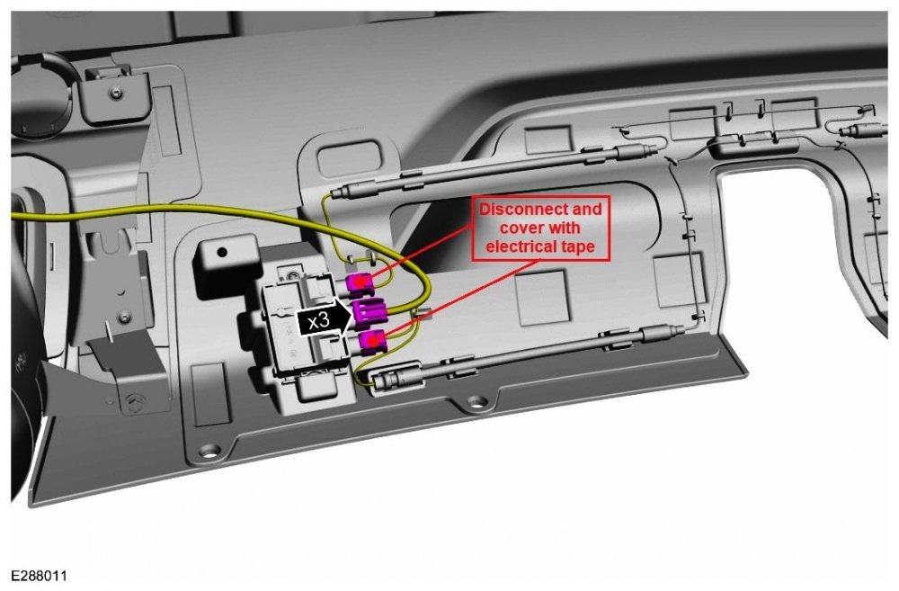

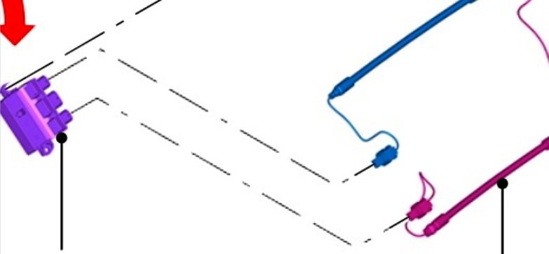

Disconnecting the upper & lower sensors' two electrical connectors from the Hands-Free Liftgate Actuation Module, located inside the rear bumper cover toward the passenger side, will fully deactivate the Hands-Free Liftgate function...
106563494_HandsfreeLiftgateModuleConnectorsLocationIllustration-2022EdgeWorkshopManual.thumb.jpg.11d232c0166228f95115bcd9973cea68.jpg
2003942808_HandsfreeLiftgateModuleandUpperLowerSensorConnectors-2022EdgeWorkshopManual.thumb.jpg.28b4b71dd2b865aa066a315e3b511fde.jpg
1221809952_HandsFreeLiftgateSensorConnectorsandModuleIllustration-FordParts.jpg.2ec5c92907cd495584fbc198d6cc245a.jpg
Once removed, wrap the connectors and vacant Module receptacles with electrical tape to protect them from moisture intrusion and road debris, just in case at some later date,  you or a future owner wishes to restore the Hands-Free function.

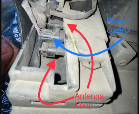

In addition to the directions Haz published, a guy in tbe explorer forem wrote about disconnecting the antenna and the exact procedure to do it (what panels to pry, etc. Now tbis is for the explorer but could be similar. Might be useful.
https://www.explorerst.org/threads/tailgate-disabling-the-kick-to-open-or-close-motion-feature-full-pictures.1938/

In the above-linked Explorer ST Forum discussion, the Explorer owner uses the term 'Antenna Loop' to describe his vehicle's two separate Hands-Free Liftgate Actuation Sensors...
Photo courtesy of KNTRDR

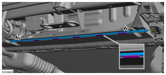

Explorer Lower Hands-Free Liftgate Actuation Sensor

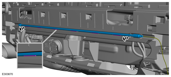

Explorer Upper Hands-Free Liftgate Actuation Sensor
imagen2.dll?id=E303670_EUR&w=580&t=JPG
The Explorer owner's direction is to disconnect the Upper Sensor and to leave the Lower Sensor plugged into the Hands-Free Liftgate Actuation Module, and there are no subsequent comments in that discussion saying the Hands-Free function continued to work after disconnecting the one Sensor.
Looking to the Edge Workshop Manual description, the Module presumably compares electrical values generated from each Sensor and interprets simultaneous changes in the two Sensor inputs as the owner's leg sweep, which when the Intelligent Access key fob is within 3-feet of the Liftgate, triggers a power-open result (as long as the Power Liftgate is not deactivated via the Instrument Panel settings menu).
So, disconnecting one Sensor may sufficient to prevent the Module from recognizing an underbody leg sweep, by eliminating the second Sensor's electrical input from comparison by the Module to the other connected Sensor's input.

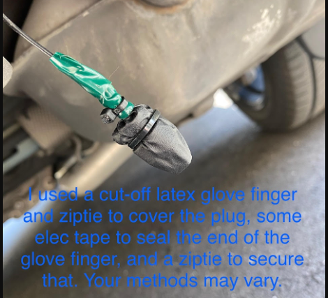

The Explorer owner's recommendation to use vinyl/nitrile gloves' cutoff finger sections zip-tied to an unused connector or module receptacle for protection from water intrusion and road dirt is a great idea that I will surely use in the future...
