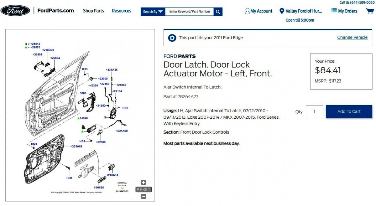

Haz Posted March 31, 2023 Report Share Posted March 31, 2023 (edited) For future reference: Ford's parts website provides hi-res/large format images of the right and left front latch assemblies which might enable drawing conclusions on door ajar switch location... Links to Left Front Latch images - Photo #1, Photo #2, Photo #3, Photo #4; Link to the following FordParts webpage Links to Right Front Latch images - Photo #1, Photo #2, Photo #3, Photo #4; Link to the following FordParts webpage Document download links> TSB 18-2013 - 2011-2013 Edge-MKX + Other Models - Door Ajar Lamp Remains Illuminated With Doors Closed.pdf Front Door Latch - Removal and Installation - 2011 Edge Workshop Manual.pdf Front Door Latch - Removal and Installation - Enhanced Pg 1 Illustration - 2011 Edge Workshop Manual.pdf Front Door Latch - Removal and Installation - Enhanced Pg 2 Illustration - 2011 Edge Workshop Manual.pdf Rear Door Latch - Removal and Installation - 2011 Edge Workshop Manual.pdf Good luck! Edited April 9, 2023 by Haz 2 Quote Link to comment Share on other sites More sharing options...
